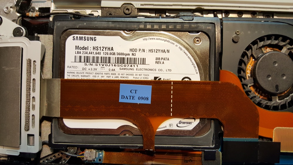

Thank you for the replies. I was looking for a temp fix until my SSD comes in to try and speed me up past the pata/zif speeds of my upgraded 120gb hard drive. I figured being 2.0 it wouldn't be as fast.
Now my issue is choosing the right SSD. I'm looking on ebay and I see them with the following specs below. My question is how fast 64MB/S is comparing to a fast hard drive such as 7200 rpm.
I'm willing to lose storage space to increase performance.
EDIT: I've attached a pic of my current upgraded HD.

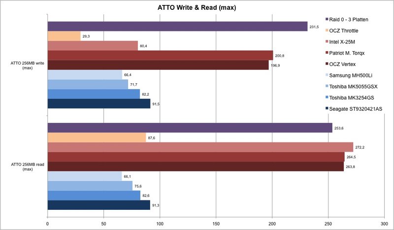

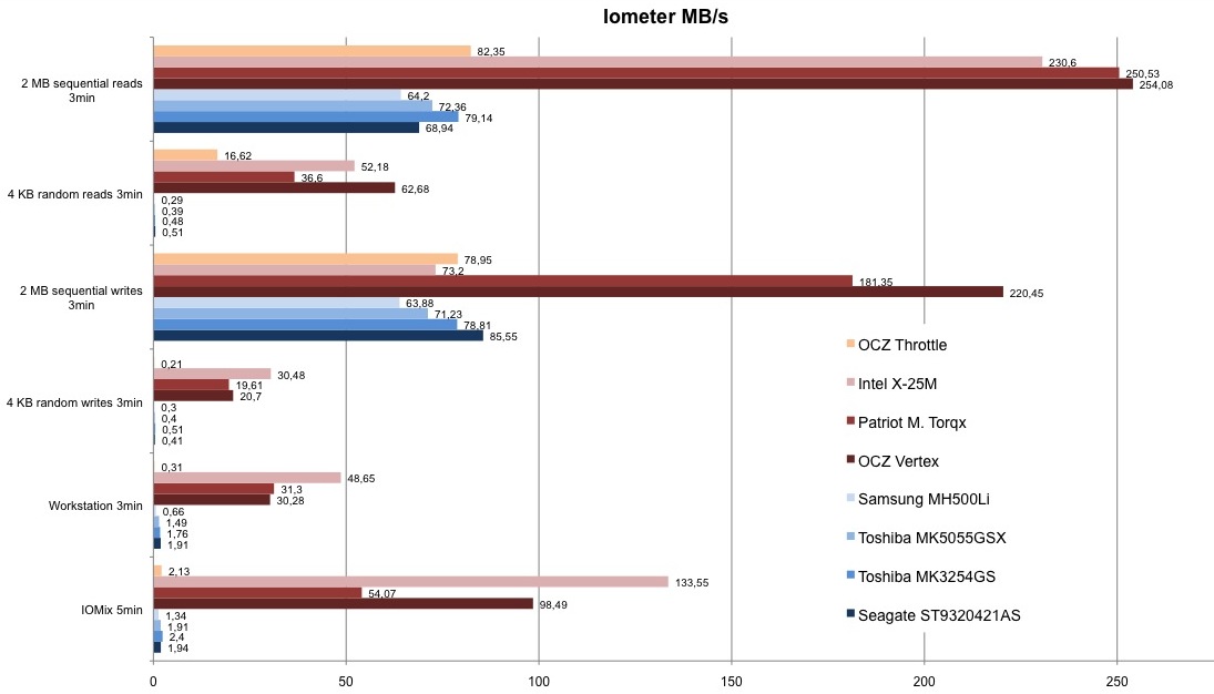

The sequential rate is not terribly useful as a benchmark, as not much is done sequentially.
From: http://www.notebookcheck.net/ssd-versus-hdd-in-comparison.18750.0.html
The blue bars are a 5400rpm Samsung, a 5400rpm Toshiba, a 7200rpm Toshiba, and a 7200rpm Seagate. These are the sequential rates. On this test 64MB/s is about 20-30% slower.
This graph shows the strength of SSDs, namely that they still give good performance under random access. You can see that traditional hard drives are terrible at this.
