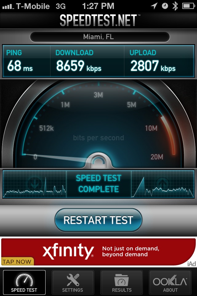

    I'm using tmobile now and in my area I get 3G speeds. Do not know if these speeds count as HSPA+ but they are fast. Take a look at these crazy speeds on 3G. ImageUploadedByTapatalk1361584571.453757.jpg

    Interesting. That article talks about the 4S but even if its there on the i5 like you said its not something you can change or edit with a JB.
