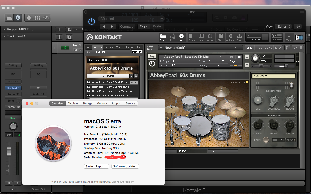

Thanks. I say Kontact 5 because it's flagship so chances are if that works others will. Plus it's the engine for 99% of the 3rd party libraries out there.
[doublepost=1466300799][/doublepost]:) all cars go!

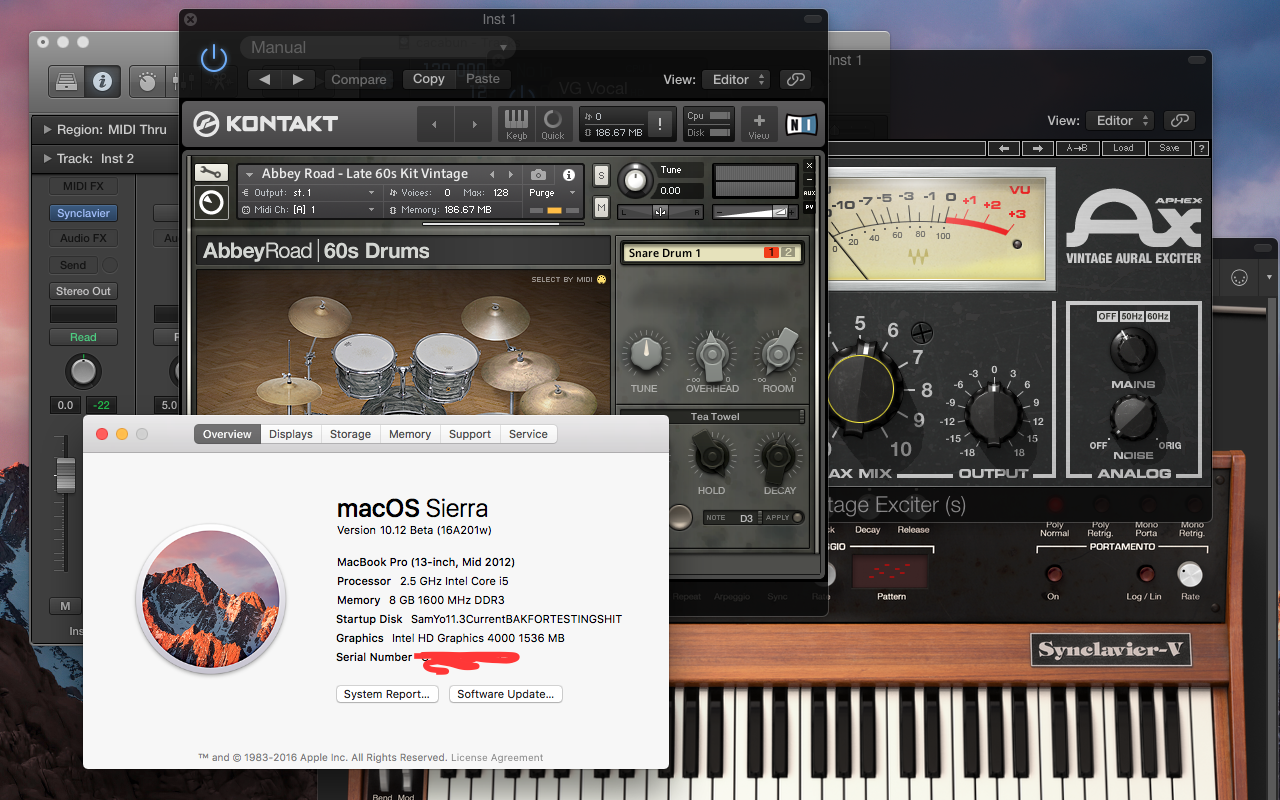

ok. I cloned my current El cap partition that I use daily for production, on an external usb3 drive. I then installed Sierra on it. A part from a hang when I started Logic up (force quit and restart), all went smoothly. 1 or registry errors, but everything else was fine. I also made sure I didnt have "Validate all AU's app" active in any way. I stopped validation after around 100 AU's (I've got, like, 1000:eek:). But I tested most important plugs for me, and they work. I can test some others, later.
I may be just lucky with my configuration, etc..., but, I didnt do anything like replace the audiounit.cache....
