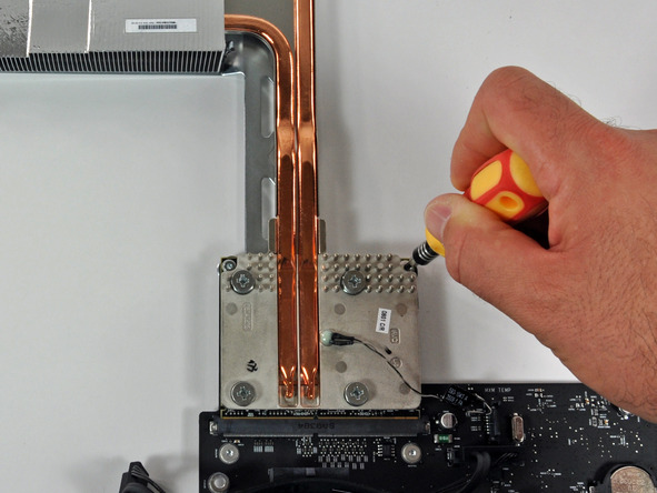

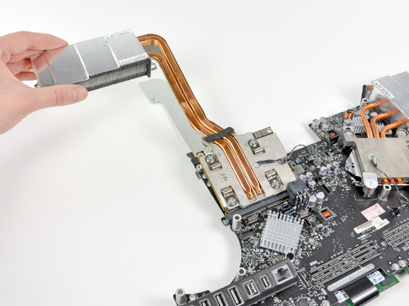

they look virtually the same thing. like i say noticable differences are the power connector thing above it (maybe for a next generation card), and the cooler has a bit cut out the top to make it suitable for the new card (2 chips on the top left of the 2011 model).

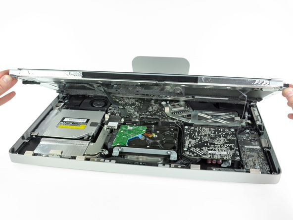

after a look at this photo...
4EJ1DAZtbEYbOBhF.medium
that shows that the extra power connections above are for the relocated hard drive. they should be a direct swap... wether or not anything will hinder them working is another thing but i couldnt see why they wouldnt? can anyone shed any light on this?

i shouldnt need the cooler by the looks of it, looks like its just the top corner has a little notch removed, DIY can fix that.
wrong photo, on another photo i clearly saw a cable connected to that connector (receiver of power), and cable was coming from psu i think.
and u will need such connector on 2009 imac if u wanna run 6970m
yes your right thats the underside isnt it, so that power connector is like the additional power connector on a standard PCI-X slot?
