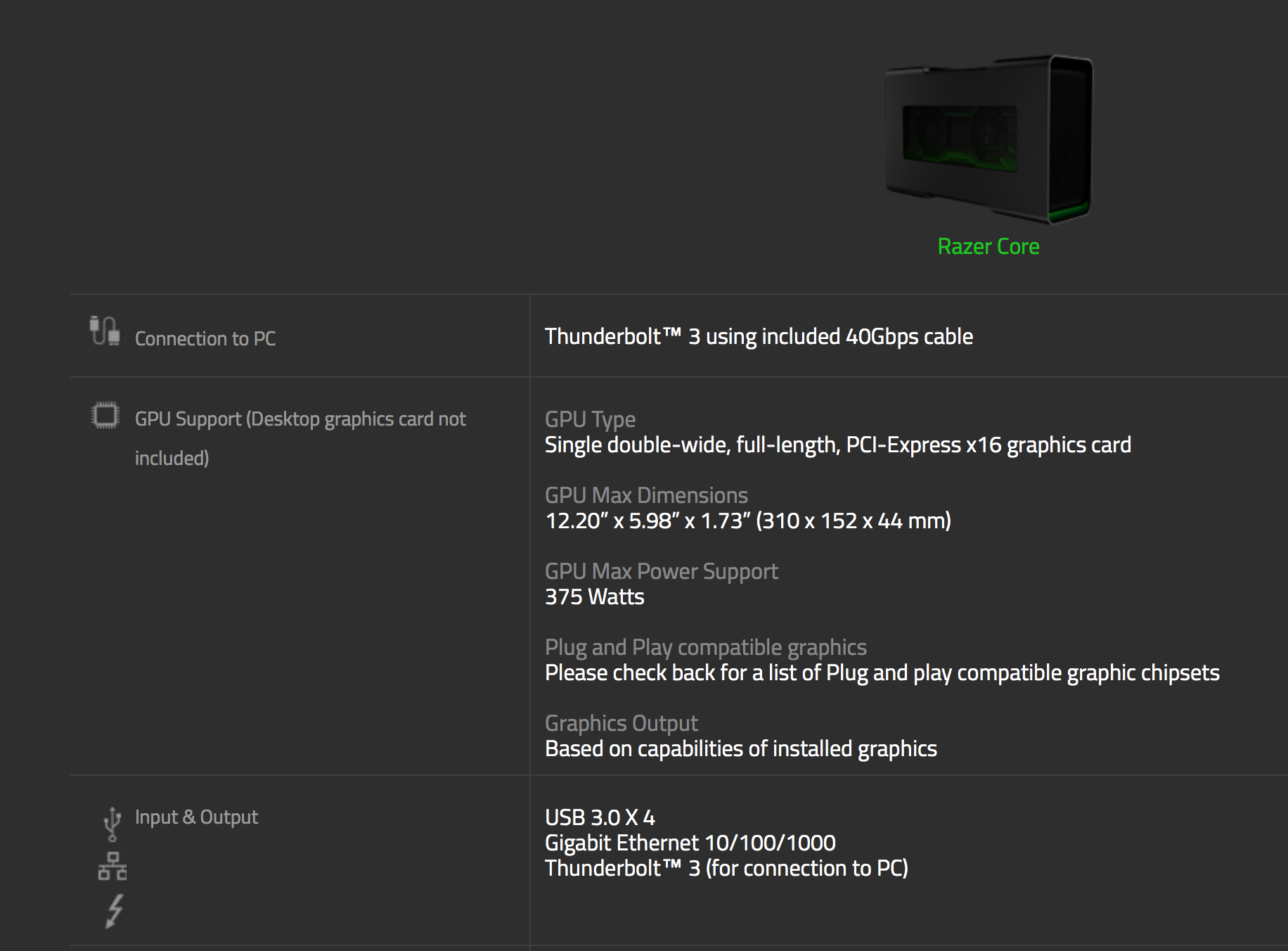

NP 🙂 would just hate for people to buy the Core with the expectation it will work with the 2015 MacBook, as it won't.
A closer look at Razer`s Core specifications answers the question unambiguously;
Q-6
