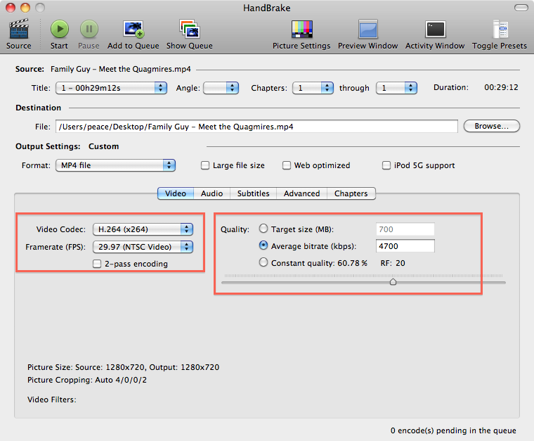

Here's a good setting for watching good quality on a HD TV.
Make sure you select 29.97 NTSC. That is very important.
It reduces the size of the file greatly without losing quality.

Make sure you select 29.97 NTSC. That is very important. It reduces the size of the file greatly without losing quality.
I'm curious about this as I'd never heard the advice before. I just tried it with a quick 2 chapter encode of Avatar (had the source rip handy) and leaving it on "Same as source" resulted in the smaller file.
Depends on what the source is. If it's HD @60FPS it will be a larger filesize. When you change it to 29.97FPS NTSC you are actually removing half of the frames reducing the size of the file while maintaing most of the quality. NTSC is the default for a lot of video as is ATSC.
That's bad advice. You should almost always chose 'same as source'.

If you choose "same as source" and the video happens to be 60FPS you're going to wind up with a 2hr. movie thats 15GB.
Using the 29.97 it will be around 5GB.
[edit] I stand corrected.
I took a 5GB HD720P video that was a native mp4 @59.97 FPS and encoded it using both 29.97 FPS and the same framerate @ 59.97. Both files came out the same size. Around 1.05GB
Well I learn something new everyday. I've been using 29.97 NTSC on all my HD TV recordings. But in all honesty they both look the same.
[/edit]
Did you set the target bit rate the same for both?
That's a pretty arbitrary number, but ignoring that fact, why would twice the frame rate end up being three times the data rate? You'd be able to specify a larger key frame value, so you'd probably be looking a 60p being something like 1.7 times the data rate of 30p.
But my point was that 60p is most probably the least common frame rate for HD material at the moment, so it's ridiculous to blindly base your settings on the off-chance it might be 60p.
