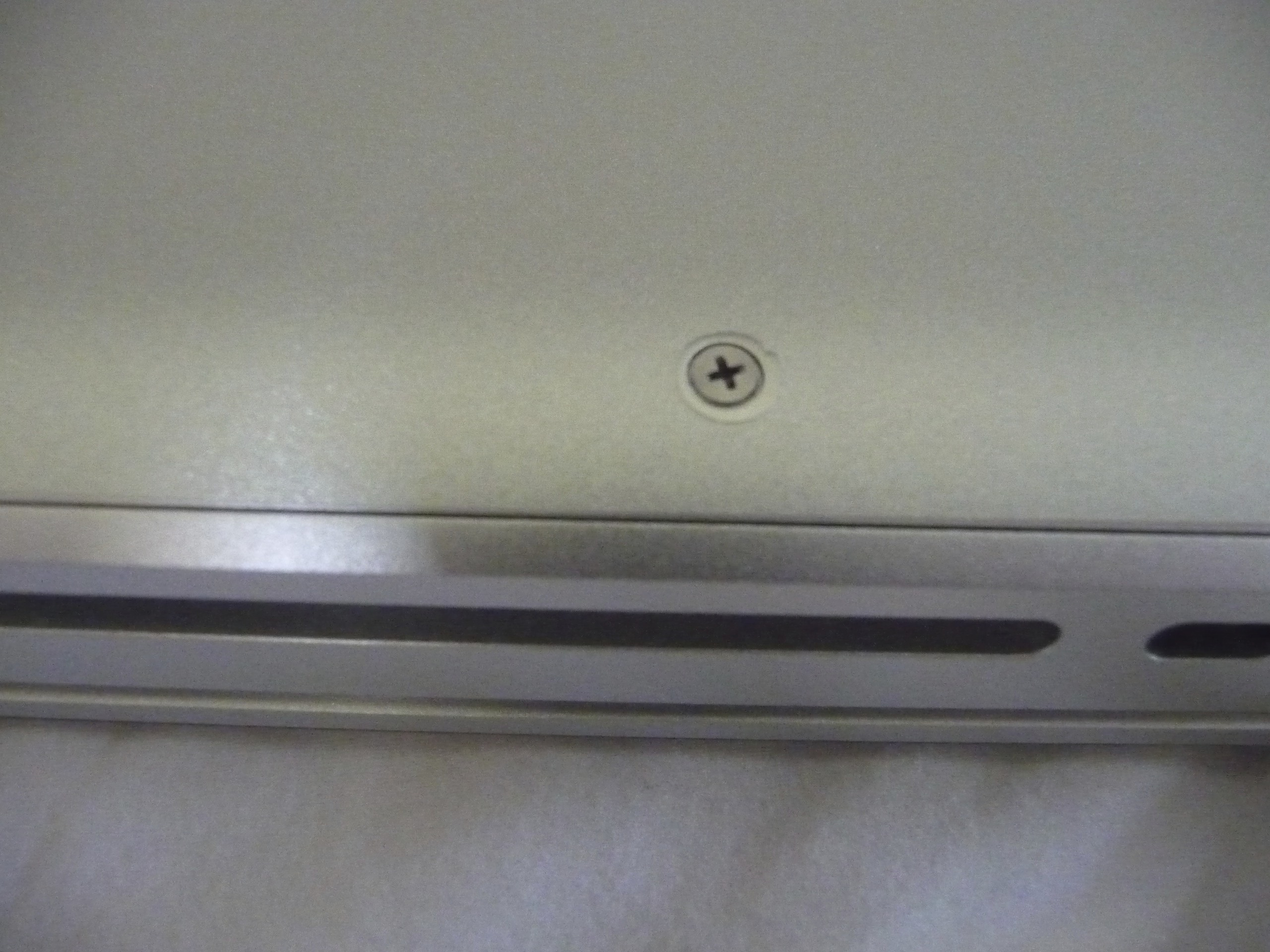

I installed mine last week. I installed bottom first. I did everything according to the video and didnt have any problems. I watched several videos on Youtube. Didnt hurt. It took a long time but thats because I was stretching it so it aligned with edges. I sprayed generously but it wasnt too wet. I sprayed my hands and stretched it with my hands and that little cloth that came with it. Basically my Mac got a massage.
Take a look at the end product. Im happy. Just took a lot of patience.
