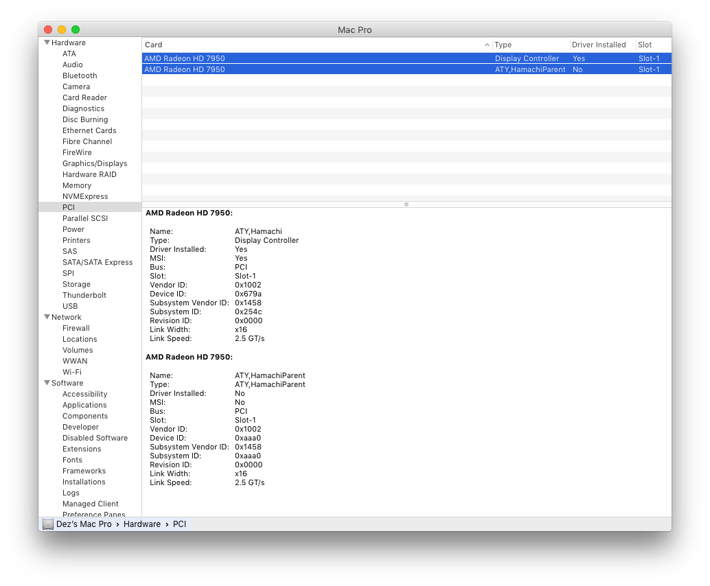

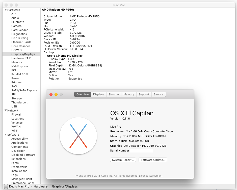

[doublepost=1540425255][/doublepost]Hello i realize that this is an old post but maybe someone can help me from pulling my hair out.
I also have a "Gigabyte AMD RADION HD 9750" card - but hey, it seems that they decided to make different versions of the card to confuse people. Mine is a Windrush version with 3 fans on the top.
It has a 6 pin and 8 pin power sockets.
When you install it into the system it does not wake up or do anything.
I know that the OROM is flashed for PC so i'm not expecting to see an apple logo but i expected it to come up once the El Capitain MacOS booted. But nothing....
Do i need to add add an 8 pin socket to get this to work?
the six pin socket will plug into the RHS of the 8 pin socket currently.
Any ideas?
Is it just a dud card?
many thanks for any help, Mike

you need to have both the 6 and 8 pin plugged in
I use two Mac Pro 6 pin cables 1 for the 6 pin on the card and the other goes into a 6 to 8 pin cable that goes into the 8 pin on the card

STOP power up the card until ALL pins are connected.
Running a graphic card that not properly power may cause permanent damage to the card.
