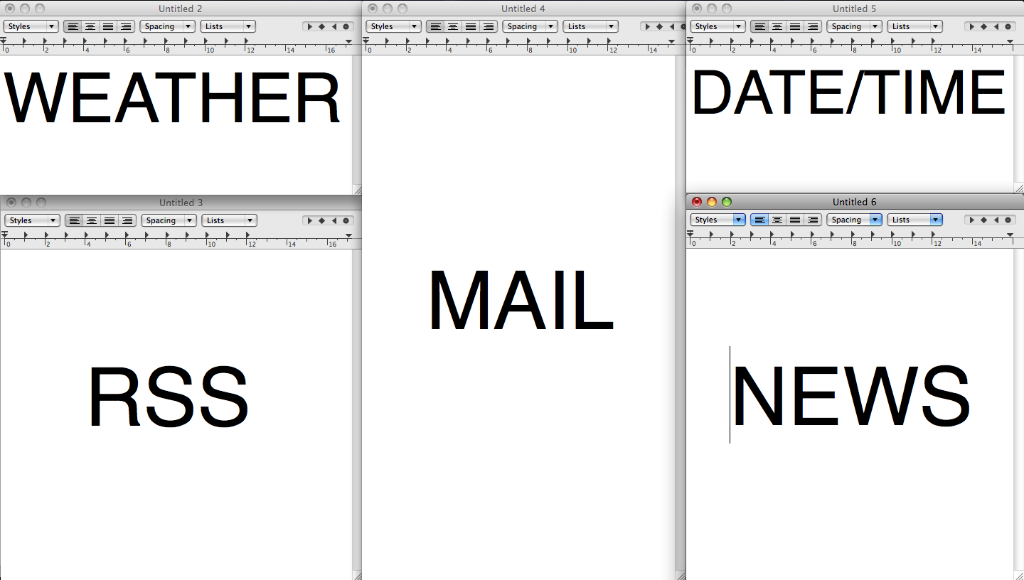

I'm interested in building an iPad app that I can use as a morning routine app. There is a similar app available called "Morning - Weather, News, To-Do, and more", however I'd really like to incorporate mail and RSS feeds into an app like this.
Is there a simple(ish) way of doing this? I've attached a very rough idea of what I'd like it to look like.
Thanks in advance.

This is exactly the same App I wanted to make... Its pretty complex to do I think (based on my research). Therefore I was going to study code, then go on to do this...
The front end that you've wire framed would be quite easy to build.
The problem you've got is that you got find a nice way of scraping the data from all the different services you've described.
Take mail as an example; there's no way to pull in the existing mail accounts the user has on their iOS device, so your going to have write a mail reader at the very minimum. That in itself is going to be quite in depth, given the various flavours of mail protocols that are knocking about.
You're going to face the same issues with each service you want to support.
I guess you could build a web service that will aggregate all the services into bite size chunks that your app can consume. It would be easier to buy in service clients for this kind of environment.
This is just based on my experience, mind. They're might be a clean way of doing this that I haven't thought about.
