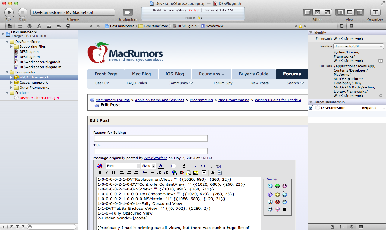

In my case, this yielded the following output, which let me know that the sidebar visible on the left hand side of the main Xcode window is of the class IDENavigatorOutlineView - presumably a subclass of NSOutlineView, which means I can look into the methods that class provides to get an idea of how I can interact with Apple's private subclass (I'm finding this to be one of the most exciting programming projects I've ever worked on...)

(Previously I had it printing out all views, but there was such a huge list of them that - though it was surprising they existed even though I was a few clicks away from being able to see them - weren't helpful.)

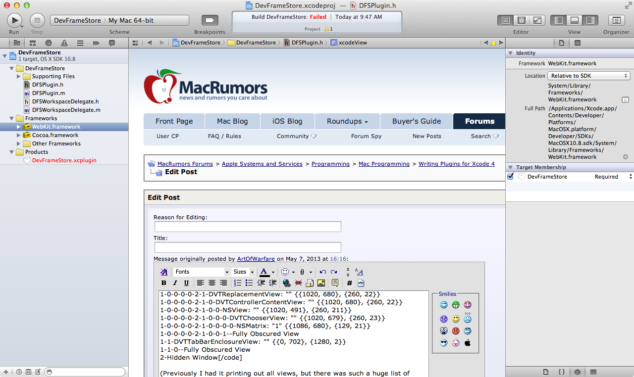

Edit 2X: I wrote a plugin that lets me browser MacRumors whenever I click on a framework on the navigation bar in Xcode... although I can manage posts, it seems that I can't upload attachments from this... I'll have to switch to Safari to upload a screenshot of it. In the screenshot you can see that the navigation bar above the editor doesn't change properly... further, the navigation bar doesn't allow you to select frameworks using it. Also, my code doesn't properly account for the possibility of multiple tabs, windows, or assistants right now, but still, I'm getting excited about the possibilities here...
I feel like tearing apart Xcode like this is teaching me a lot about the structure of OS X apps and GUIs...
