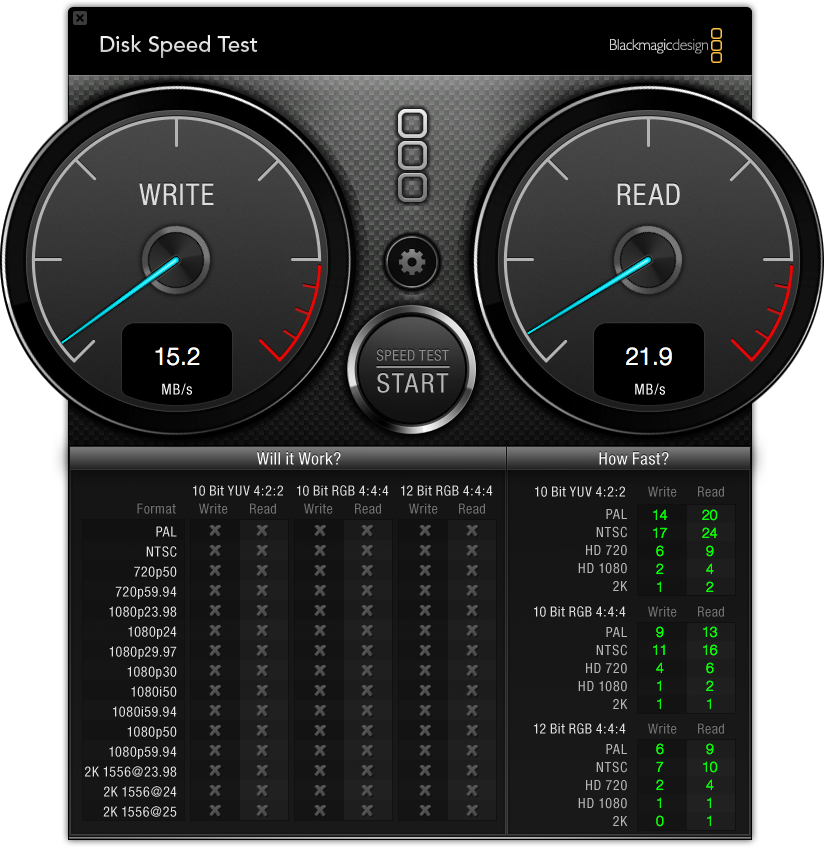

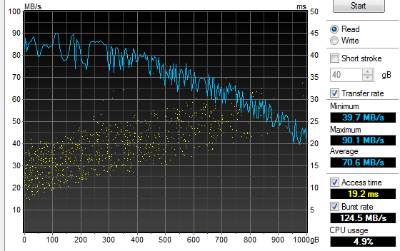

My WD Passport is USB 3
but I test on Black magic speedtest
It show 15 - 21 MB/s
So...next I test on Bootcamp windows 7 with HD tune
That's work fine about 50 ~ 70 MB/s
*Other device of USB 3 Harddisk work perfectly on mac
What wrong with this...?

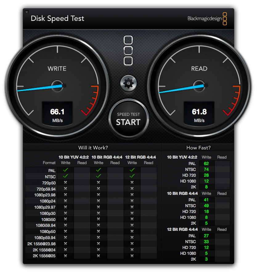

How does black magic even write to the drive if it is NTFS?
That could be the issue, if he's using a third party driver such as NTFS for Mac by paragon, that could explain why its slower. The app is not as optimized as it should.
And here I was thinking my WD My Passport drive was slow. I guess it's not...
