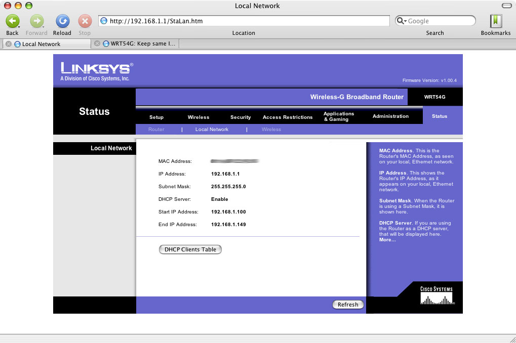

Its 192.168.1. Here's a screenshot from the router setup that shows that info:

Just to confirm, does anything here look wrong:
BTW, I tried the same steps on my Powerbook and the same result, so it doesn't appear to be anything wrong with my G5

No, that looks correct. And you should not receive a response when pinging 255.255.255.0 so that is nothing to worry about.
