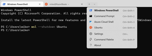

From a powershell window type: wsl --shutdown Ubuntu
Close the Ubuntu window and open another
From the powershell window you can start a new Ubuntu instance. Click on the down arrow and select Ubuntu

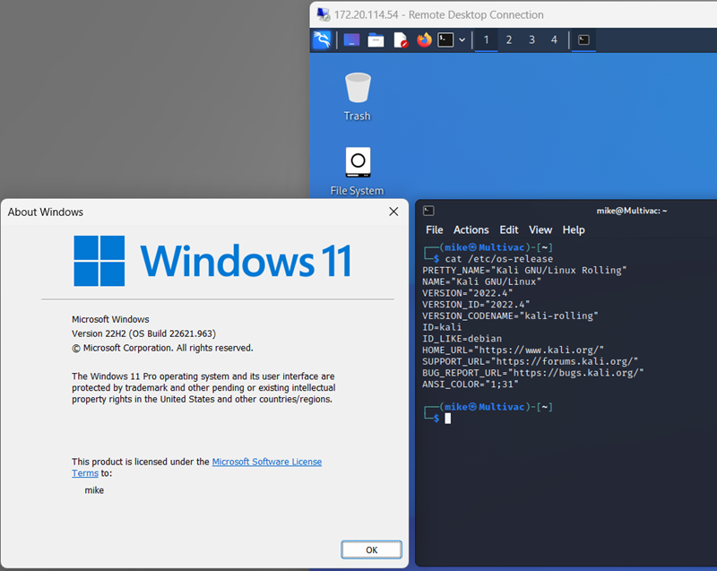

Whelp,
I did it, at least this way.
I installed kali linux, and the DM. It wasn't anything related to my skills but this video
The biggest difference is setting up kali and xfce to basically run in WSL and then RDP to remote into the environment. I stumbled upon other suggestions regarding kali I'm going to play with them, but this is exactly what I was wanting
