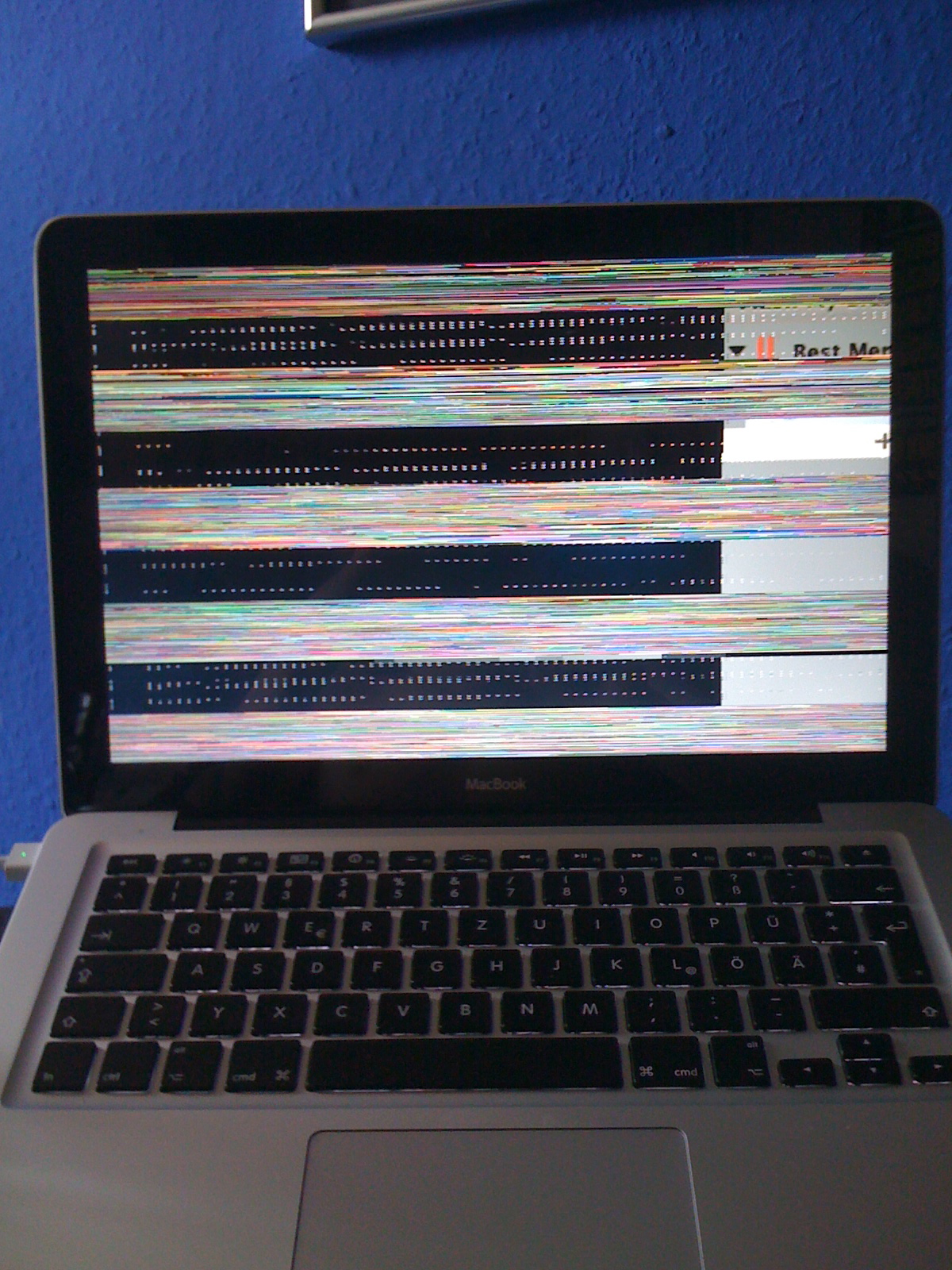

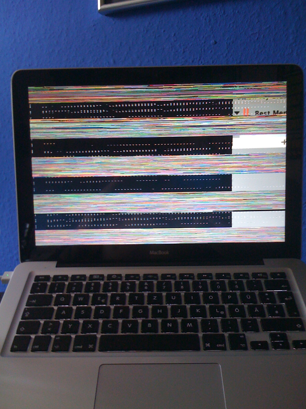

I don't know can someone maybe tell me what this could be? It looks like overheating GFX but maybe it is really just a Software bug (I hope)
After this appeared I couldn't do anything and had to force a shutdown
You can try restarting and see if the problem goes away. If it doesn't, looks like a fried 9400M which will get you a logic board replacement.
yes it is gone now could it still be a hardware error or high temps? Or maybe it was just a bug?
Could be due to abnormally high temps.
Were you doing something very GFX intensive? You can install iStat Pro to run as a dashboard widget and that has a GPU diode temperature readout field.
