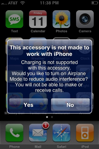

Only problem is, i'm using the same exact USB cable that I have been using for nearly 2 years. It all the sudden is swithing between not being supported and charging (which is annoying, as the phone is vibrating twice every 15 seconds now). Anybody have any clue?

Most of you iPod/iPhone users that was met by the message "Charging is not supported with this accessory" has the same problem as I have.
The problem is that you bought a new Apple-product !!
Without any warnings to their millions of customers, Apple have changed the charging circuitry of their new devices so they only accept charging from USB-based (+5VDC) chargers. Earlier i-products also could charge through Firewire-based (+12VDC) chargers as seen in many car-installations and integrated iPod speaker systems.

For all you who have this charging problem, you might resolve this by buyng a Firewire-to-USD converter from Ridax, CableJive or Griffin (look for "Charge Converter") 🙂
