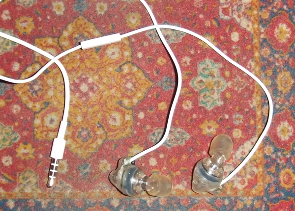

Certainly not the wisest thing I've ever done, but I'm phone poor now so I can't go out and buy new headphones. Plus despite mixed reviews, I really like my Shure e2c's. Behold the first(?) Shure/Apple hybrid headphones!
Sounds great... Mic works, plus I get to keep the nifty button for skipping songs/hanging up on people.

Has this affected the audio quality at all? How did you do it?
And, could you just do it because of the way the E2c's are designed, or would this also be possible with other earphones (ie. Future Sonics Atrio M5)?

Thanks, ya'll... It was actually pretty easy. The covers on the iPhone earphones "pop" off by putting a pocket knife just under the grey rubber that surrounds them. There's a tiny circuit board there with two solder points... I just unsoldered them (could have cut the wires too I guess) and untied the knot in the wire that keeps the connections from pulling loose. Did the same things to the e2c's (the clear plastic in the back is in two pieces and can be pried off with a knife right down the middle). There's not much space to work inside the e2c's but a quick touch of the soldering iron took the wires right off. The color combos of the wires on the iPhone cable didn't mean much to me - and the solder points on both sets of headphones weren't marked for polarity so I just made sure to solder in the left and right earbuds in the same way. Seems like with earphones the polarity is not critical as long as it's the same for both ears (to prevent phase problems?) I'm not an electronics expert so someone may know more about that than I do. I would imagine that the same procedure could be done with other earbuds as long as they would come apart without breaking. The iPhone earbuds come apart quite easy.
Mark, the sound quality is great - The e2c's originally had a heavier wire going to them but I don't notice any difference with the OEM earphone wire. The only annoying thing is that the iPhone doesn't appear to provide any talk-back (your own voice) into the earphones when you're on a call. Since the e2c's kill so much external noise with the way they fit in the ear canal, my own voice became very soft (only to me, not to the party on the other end) and that gives me a tendency to talk too loud. I'll get used to it tho. I superglued the e2c's shut so they're not coming apart anytime soon, but attached is a picture of the OEM earbuds.

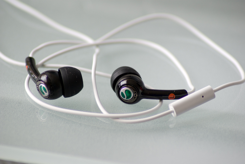

Rather than use my nice ultimate ears set, I used the sony one that came with an old phone. MUCH more comfortable and much better sound. These are the same earbuds as the Sony MDR-EX51LP:
It was too complicated to tie the cord so I just used a lot of glue to fill in the whole long end there.

The same earbuds in white exist for about $25 on ebay brand new, but I didn't think it was worth it since I already had these here free.
For some reason the apple earbuds really hurt my ear when I leave them in for about 5 minutes. Also, the only way for my ears to hear any bass from them is to hold them tightly to my ear which of course would look very weird walking or jogging around.
The sony ones are cheap and are extremely comfy for my ears. They also have good bass.
