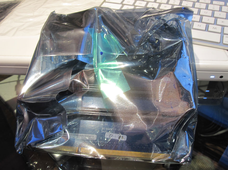

Woooo!!!! Today, a new replacement Card Riser arrived.
So it's out with the old! 🙂🙂🙂
....what to do with the old one???
