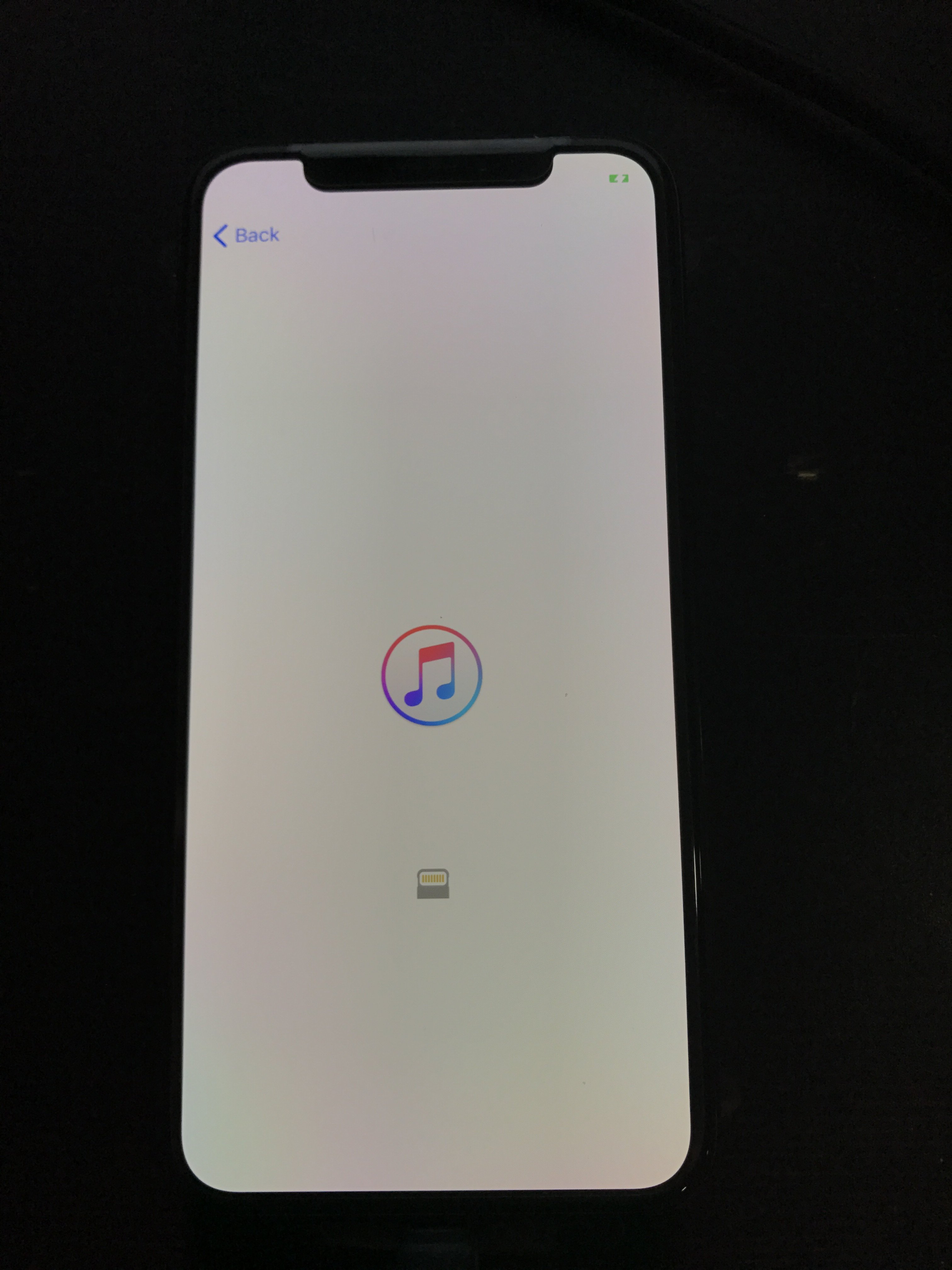

One of my iPhone X's will not restore from a backup. It starts the restore and says the estimated time remaining and a progress bar. After about a minute the backup fails saying it was corrupt or not compatible and my X restarts and either shows a white background with the iTunes logo and the very tip of the lightning cable or just to the 'Hello' page, though when it's attached to iTunes it shows that it renamed it to 'iPhone 7' but nothing is on there from my old device. I've set up as a new phone then fully erased everything and that hasn't worked either. I'm restoring from an iPhone 7 (iOS 11.1). I was successful on the other X's when restoring from the same iPhone 7 backup.
Adding that the right side from the top of the lock button to the bottom of where the sim tray stops is extremely warm, more so than anything I've experienced in a phone

I have tried that. The backups have worked successfully for other phones though which has made me curious. I have deleted all backups and did a fresh backup of my iPhone 7 and put the iPhone X into recovery mode and I am still unable to restore. I may take this phone to an Apple Store today to see what they say because I have setup as a new phone and it behaves very laggy compared to the other X’s I have set up. I first noticed something was off when it showed connect to iTunes for the first time, picture attached.

Yes all phones were updated to 11.1. I have since set up the phone as a new iPhone and ended up returning it. Face ID stopped working and it kept restarting all morning and it constantly would get unbearably hot.
