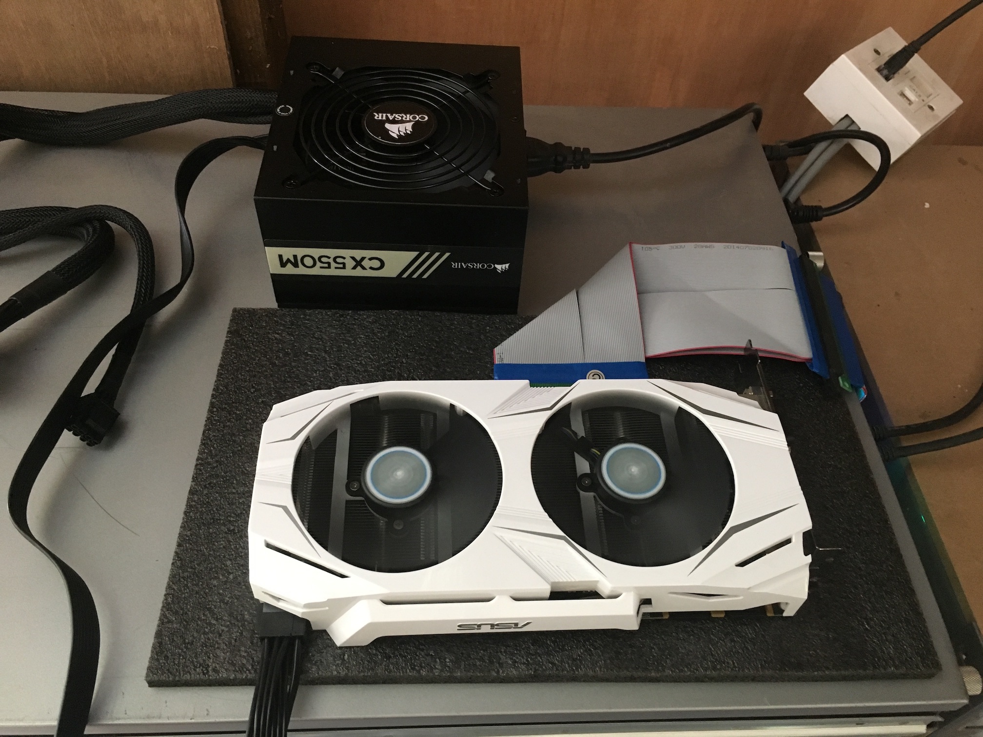

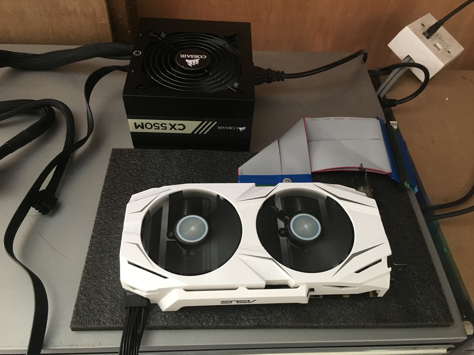

I have also installed a GTX1070!!! I have achieved this with an external power supply and a PCIe extension cable. The GPU now rests quietly on top of the box
However, this GPU is only used for rendering, I would also dearly like to have a good GPU for graphic display (And if it happens to have a few cuda cores then so much the better.
Any recommendations?
