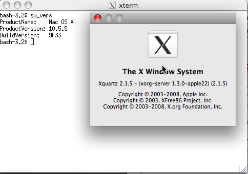

Weeeellll... my X11 runs fine and I haven't updated it. Dunno what to say there. So, it's sorted for you now, or still downloading?
My Xquartz was built on 9-24-2007, so it looks like mine is a little older than yours. Anywho, still downloading, and I appreciate the help.
Ah, unless you specifically selected X11 as an optional install in the Leopard installation process, that's probably the old version from Tiger, which (IIRC) doesn't work worth a **** with Leopard.
