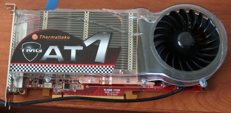

I decided to go with the TMG AT1. So far it works great. Its no louder than the stock fan at idle, it keeps it cool, it exhausts out the back where the PM air naturally flows and it doesn't sound like a die grinder at full load. 🙂
The only down side is it occupies 2 slots. When combined with the 7800 GTX 512 below it means all 4 of my slots are occupied.

I go along with Lord Zedd - G5's will lose a PCI slot but in a Mac Pro that is allowed for.
I Installed the ThermalTake AT1 on my X1900XT and saw immediate results from the thermal probes I stuck around it. It is as quiet (or even quieter) as the ATI stock fan.
For my Mac Pro I bought the special cable that runs to the spare power socket under the front fans - added an adaptor cable with a "Y" split - one end is a standard molex to the TMG AT1 and was able to also install a small fan over the Northbridge . . getting off the subject . .
Yes, the only choice for a Mac Pro with an X1900XT is the ThermalTake AT1.
