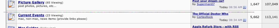

I am getting some odd graphics problems with my x1900. I don't know if its the 10.5 driver issues or my card failing. I am getting lines across just one window that go away. I get the minimize effect for just about an inch of one window until i move the window. When i play 3d games when it warms up lines start going straight off items. Its hard to describe but it will just continue a line right off the screen. Here is a screenshot of the line on the windows problem. Would this be drivers or my card?

This is normal for the X1900, since it is a crappy card running too hot. 🙂
Its common, but not normal. It didn't do this for the past year and a half i have owned it. 😛
Any thoughts on the second monitor?
EDIT: wouldn't the thing i have as screenshot of be a drivers issue? otherwise it wouldn't show up on a screenshot.
These are the symptoms of an overheating card, most likely caused by dust buildup. All it needs is a good cleaning.
Blow the dust out of the air intake vent and clean out the fan assembly. For extra credit, apply some Arctic Silver thermal compound to the GPU-Heatsink interface.
I will give that a shot. I cleaned it out a couple months back. Does the arctic silver help alot? I might get some as its not to hard to apply.
The Arctic Silver seemed to help mine immensely. I experienced quite a few system and graphics freeze ups with my X1900 after upgrading to Leopard, always when the card was being stressed, like DVD playback or iTunes visualizer. All that went away once I cleaned out the card and applied some Arctic Silver to the GPU.
I sprayed off the card. It seems to be running better lines wise. However, i still have the second monitor problem.
