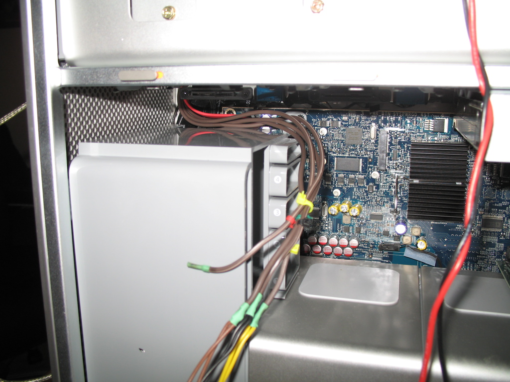

Solution:
Extend the cord for fan, and run it up another location.
Thanks for posting your solution, this is what I ended up doing as well. I've been busy with work and haven't had a chance to post pictures, so thanks for sharing yours! :apple:
I want to put some input on this cooler since I also install it myself. I can't believe how quiet it is, the fan is spinning but make no noise at all. The nice design of the cooler, where it takes hot air and blow it out of the case is a big plus! Temperature is better then I expected it. Normal load it is at 38. Hours and hours of gaming it doesn't even pass it in the 50. I could say, this is even better then the Accelero X2. However, it would have perfect if it work for the Mac Pro without running the wire to the Optical Drive, or even cutting it to close the case shut. No surprise though, it is invented for the PC.
I did ended up buying two TMG though, so I have spend over $80 for the cooler itself. First one I messup with the X cross where the screws is mounted. I couldn't get it to screw flush, I believe the hole is a bit off. Then I open up to check thermal paste, that decreased it performance so I bought another one to install fresh.

That's nice, but with the TMG you can easily take it off and re-install the original ATI stock cooler! Where other would stuck on for good! Only 4 screws mounted on the X cross to hold it together. It also use none-sticky tape on the ram, so you won't have a problem taking it off. It come right off. So no, I won't go cutting the wire on the original ATI to void the Warranty because I can still put back the original stock cooler when needed. Just have to be careful the screw mounting it, is very tiny and damage easily if you twist it too hard. I have four screw damage. Use the right screw driver and tight it gently. It's all good now, not only have I have a great working cooler, but the original to put back on in for Warranty. 😀
Thanks for all the pics and info on installing the AT1. I recently installed an AT1 to replace the stock cooler and am now much happier with it's whine noise gone.
The one place where I deviated from the guide, was that I didn't want to splice the AT1's fan cable. So I connected a 4 pin molex power cable to the optical bay area and spliced that. Works great so far...
