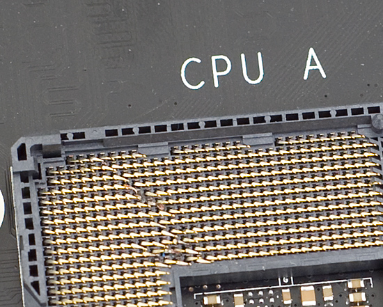

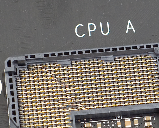

Just be sure before proceeding that you didn't bent pins on CPU socket in previous attempts.
That would be a serious problem.
