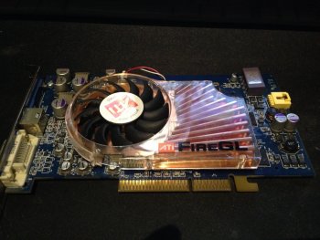

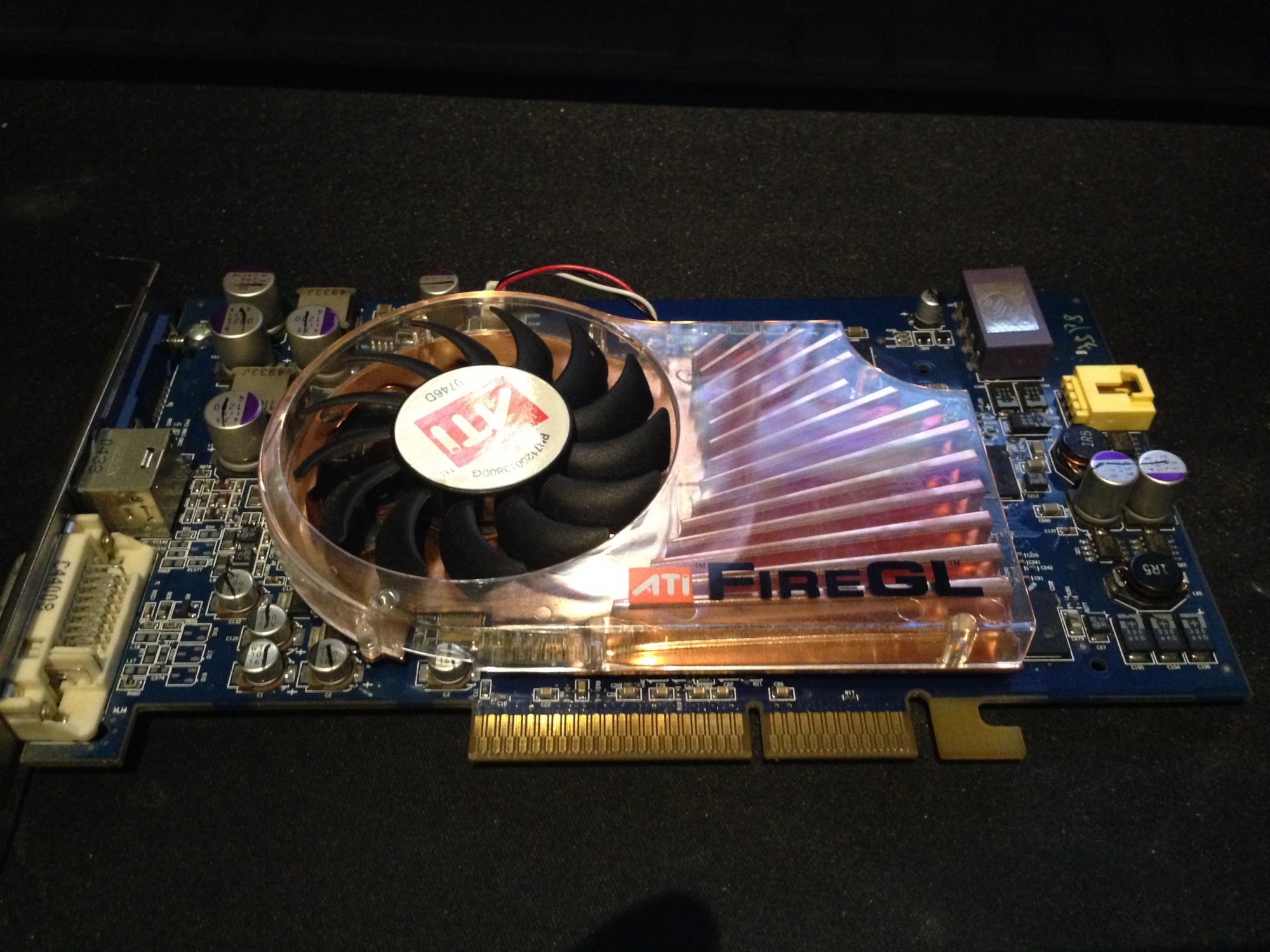

I have a FireGL X3 but the problem is that the X3 has only 12 shader. Looks like the ROM is a simple X800XT ROM without modified shader number. The X800XT has 16 shaders.
I think with this ROM you will activate the last 4 shader. This shader can be defective or ok. This is a 50/50 chance.
My 4 shader units must be defective, because i get artefacts.
3 X3-Cards 1 with artefacts

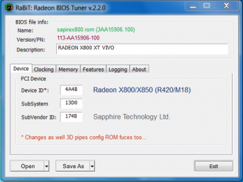

The X3 ROM from the Macelite page has an overclocked RAM (475 MHz), but the X3 normal speed is 452 MHz. I would say the RAM brand is not he problem, Samsung is just more overclockable.
By the way my ROM was modified to the standard clockings of a X3 (GPU 491 MHz, Memory 454 Mhz) but artefacts, also with 400Mhz.

Is here anyone i can ask about ROM editing and change the timing to 2 ns? In an other forum if readed it is possible, but change the checksum. So you need an external flasher (no problem for me^^)
