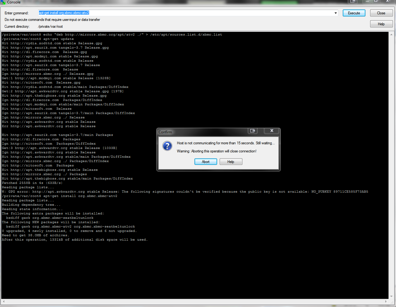

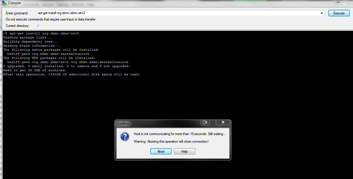

i'm having trouble getting it installed. if anyone could lend a had that'd be great.
If I had an ATV2, I'd be more than happy to help. However, I just have a dedicated ION/XBMC Live system.
But I'll try. Where are you stuck?
after i execute apt-get install org.xbmc.xbmc-atv2 winscp says host is not communicating for more the 15 seconds.... so it doesnt install.
Interesting... I'll look into that. That's weird it would hang like that. Sometimes it will ask if you are sure you want to install, prompting for you to press Y or N.

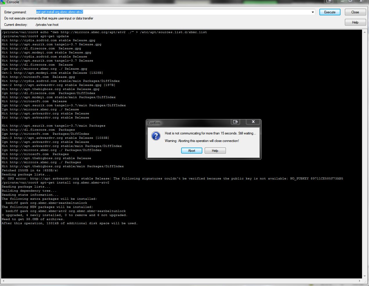

yea its jailbroken i've install atvflash (black) and i ran all of those.
Typically install commands end with:
Do you want to continue [Y/n]?
You'll notice that it will wait for you to press Y in order to continue.
but mine doesnt say that. it just looses the connection. But firecore added XBMC to install directly from the atv2 so i'm all good now. thanks for your help
