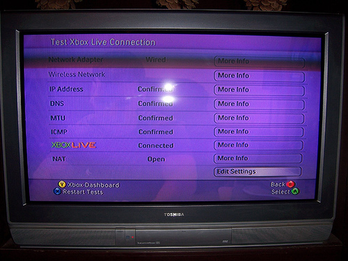

My Xbox Live connection has a NAT setting of Strict and I'm trying to get it to Open to make the most of my subscription.
I connect to the net with a BT Voyager 205 modem which feeds into a Airport Extreme Base Station (new version). The Xbox then connects to the wireless network with the Microsoft WiFi adapter.
I've tried port forwarding ports 88 & 3074 which hasn't helped and setting up the Xbox with a static IP address and then setting it up as a DMZ which hasn't worked either.
I've just worked out that my Modem has NAT functionality as well as the AEBS so I'm thinking that could be causing my problems. Has anyone got a similar set up to this? If so, what did you do to get around it?
See if you can disable the NAT on the modem and leave it on the router only with the ports forwarded, that should do the trick. Yes, you basically have the double NAT problem since both have NATs and I doubt the modem lets you port forward.
OK, I've tried disabling NAT on the modem, but all that does is stop me being able to access the Internet at all. Not sure what else I can try.
Phone your ISP (provided that they gave you your modem) and tell them that you want to bridge your modem, and use your Airport to authenticate / handle the external IP addresses.

Thanks for the suggestion sycho. Unfortunately, the modem wasn't supplied by my ISP and I can't use the one they did give me because it's only a USB interface and doesn't have ethernet which I need for the AEBS.
I'll have a search around the net and see if I can find the info to bridge the modem.

Success!
Well I've managed to get an Open NAT status from setting up my modem into bridge mode. In case anyone else has the same problem I followed these instructions and then set up my AEBS to use PPPoE. Didn't have to do any port forwarding or set up a DMZ.
