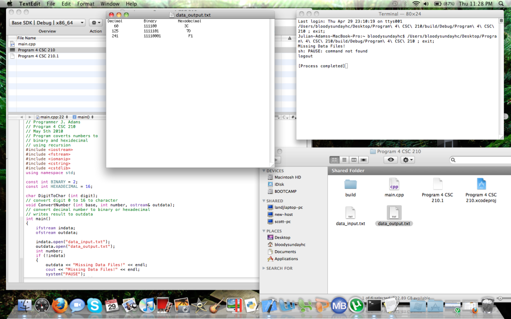

Here's everything that's going on
it outputs to "data_output.txt" fine, but if you look in the terminal it still says missing data files.

Code:
		system("PAUSE");
What do you expect this line to do? There is no PAUSE command on Mac OS X. This looks very Windows-specific.
Since your pathnames are relative to the working directory, I recommend that you print the value of the working directory, and confirm it is correct for the pathname your code is using. If it's not, then you need to change something.
You can get the working directory with the C function getcwd(). You can find its man page by searching Xcode's documentation for the function name.
If you don't understand the significance of the working directory, read this:
http://en.wikipedia.org/wiki/Working_directory

Let's see if I have this correct. From your posted image it looks like you've started the Terminal which defaults you to your home directory which looks to be '/Users/bloodysundayhc'. Then you attempt to execute your program by specifiy a "complete" path-name pair and it fails.
Try it in this order, change your working directory to the location of your executable first with:
Code:
cd /Users/bloodysundayhc/Desktop/Program\ 4\ CSC\ 210/build/Debug
Now that your current working directory is correct execute the program with:
Code:
./Program\ 4\ CSC\ 210
