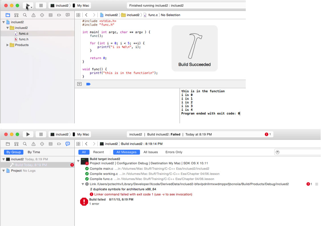

I have been trying to test some of the code I am working in Visual Studio in Xcode. I am running in to the problem when it comes time to include file in my project. When I use file add files to project, from that point on nothing will build successful. Even more the main.c that Xcode created for me stops working as well (won't build). Could someone suggest what I am not understanding or missing? Thanks

Thanks guys a great help, it is what all of you suggest. Forgive me for lack of understanding of terminology in Xcode and how to work with C constructs. I started with programing with JavaScript and PHP this C stuff is new to me. The suggestions you guys said already helped me understand better. As for the project files pane (lloyddean suggest) I never found it. I do think that is the problem “successful linking” once deleting all other files with a main function it worked fine. I am including a pic of the error message here, it also says something about linking. I would like to know why if any of you know…. why Visual Studio does not have the same problem?

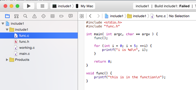

Perhaps it's the one in the image you included that contains the files "func.c", "func.h", "working.c" and "main.c"?
You show us the content of the "func.c" which clearly contains your "main" function but failed to remove the file "main.c" from the project meaning the linker is likely complaining of more than one main function in the project.
I get it, I was looking at it! I thought that is was a specific other view. Thank you so much, you and the other members helped a great deal. I am working now, and cam continue learning more. Thanks!!!
