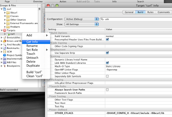

switches in Xcode
Where would switches like these -DMEMWATCH -NMEMWATHCH_STUDIO be put in Xcode?

Well, what have you tried? I'm not on my Mac right now so can't look at the available options but iirc it's pretty obvious. 2 seconds with Google suggests that "Other C Flags" might be a good starting place...
Do you mean OTHER_CODE_SIGN_FLAGS =
I was looking for CFlags but didn't find it.
Will try.
No. Given the name I would guess that OTHER_CODE_SIGN_FLAGS is for code signing. Which is not what you are doing.
As I said: I'm not on a Mac and don't have access to XCode right now. Did you try reading the XCode documentation? I'm pretty sure it covers this. Also did you search on Google before asking this? If so what did you search for?
Edit: OTHER_CFLAGS is in the Build Settings List You may have to add it as a user-defined setting:
