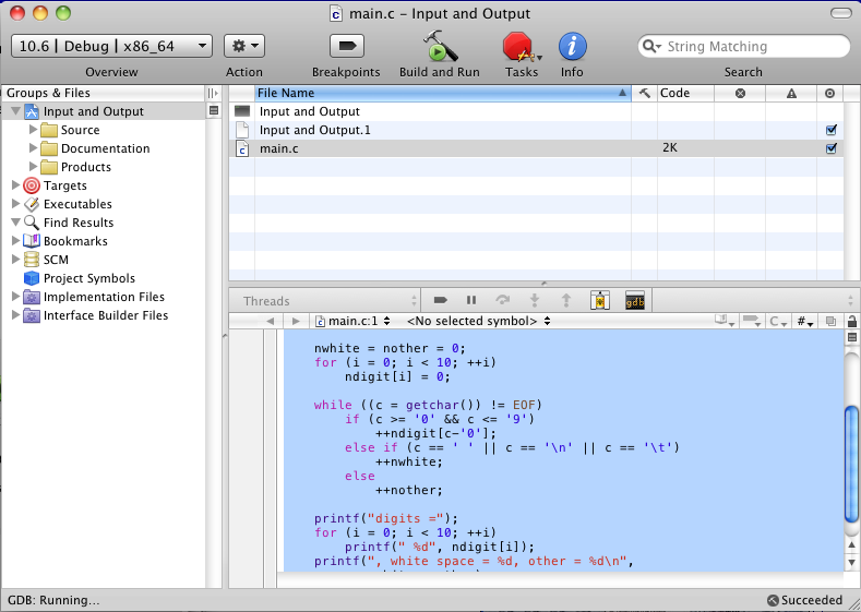

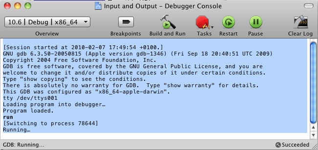

    Whenever I am trying to build and run this program, the log just keeps saying "Running..." and does not print out anything
    The program
    Code:
    #include <stdio.h>
    /* count digits, white space, others */
    main()
    	int c, i, nwhite, nother;
    	int ndigit[10];
    	nwhite = nother = 0;
    	for (i = 0; i < 10; ++i)
    		ndigit[i] = 0;
    	while ((c = getchar()) != EOF)
    		if (c >= '0' && c <= '9')
    			++ndigit[c-'0'];
    		else if (c == ' ' || c == '\n' || c == '\t')
    			++nwhite;
    		else
    			++nother;
    	printf("digits =");
    		printf(" %d", ndigit[i]);
    	printf(", white space = %d, other = %d\n",
    		   nwhite, nother);
    The log after Build and Run
    Code:
    [Session started at 2010-02-07 17:49:54 +0100.]
    GNU gdb 6.3.50-20050815 (Apple version gdb-1346) (Fri Sep 18 20:40:51 UTC 2009)
    Copyright 2004 Free Software Foundation, Inc.
    GDB is free software, covered by the GNU General Public License, and you are
    welcome to change it and/or distribute copies of it under certain conditions.
    Type "show copying" to see the conditions.
    There is absolutely no warranty for GDB.  Type "show warranty" for details.
    This GDB was configured as "x86_64-apple-darwin".
    tty /dev/ttys001
    Loading program into debugger…
    Program loaded.
    run
    [Switching to process 78644]
    Running…
    [​IMG]
    [​IMG]
    Could someone also try to Build and Run the code? If this is a bug/error, how to correct it? Should I reinstall Xcode?
    P.S. For project, I used Command Line Tool, under Application
  2. robbieduncan Moderator emeritus
    robbieduncan
    Joined:
    Jul 24, 2002
    Location:
    London
    #2
    You are, of course, typing something for getchar to return somehow? I don't know if you can do that on the XCode console. I think you may need to run the executable in Terminal...

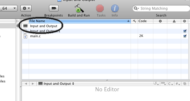

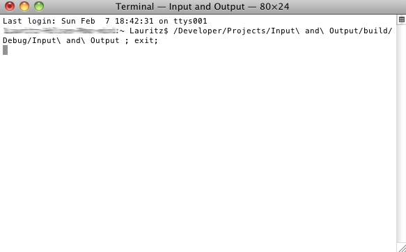

    I may have found the executable:
    [​IMG]
    but my Terminal says this:
    [​IMG]
  10. robbieduncan Moderator emeritus
    robbieduncan
    Joined:
    Jul 24, 2002
    Location:
    London
    #10
    Have you considered reading the documentation? It would tell you most of these things. Anyway expand Targets on the source list, double click the target that you are building and look under the Build tab. It will tell you where Build Products are put.
