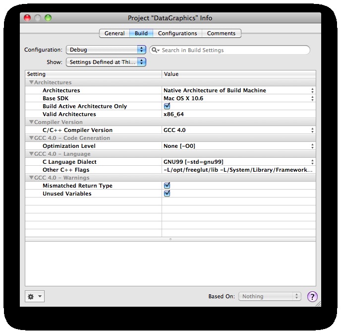

I also tried to create the project from scratch but it also doesn't work; those are the steps I've followed:
  • I've built freeglut2.4 (I need it for a project)
  • I've set the settings attached below
  • I've added the OpenGL and the freeglut frameworks
I guess there must be something wrong with those steps.
Thanks!
OK. I'll take a look at those later this evening, but first - a question. You are aware that Apple provides a version of GLUT for your use in /System/Libraries/Frameworks aren't you? Or is there something special about "freeglut2.4"?
Thank you but I can't find "freeglut" it in /System/Library/Frameworks
I can see on "GLUT" but I need to use freeglut because that's a requirement of the project.
