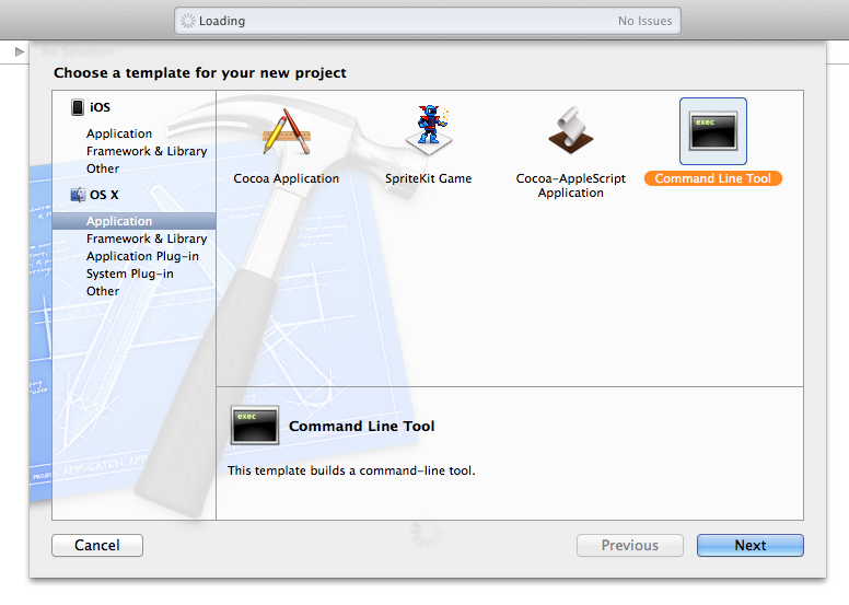

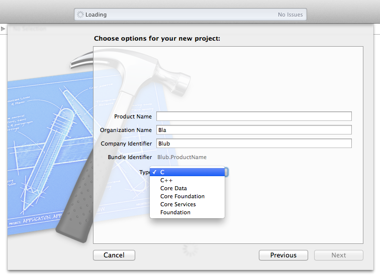

Here how the dialog after choosing create new project should look and the details that come after it:

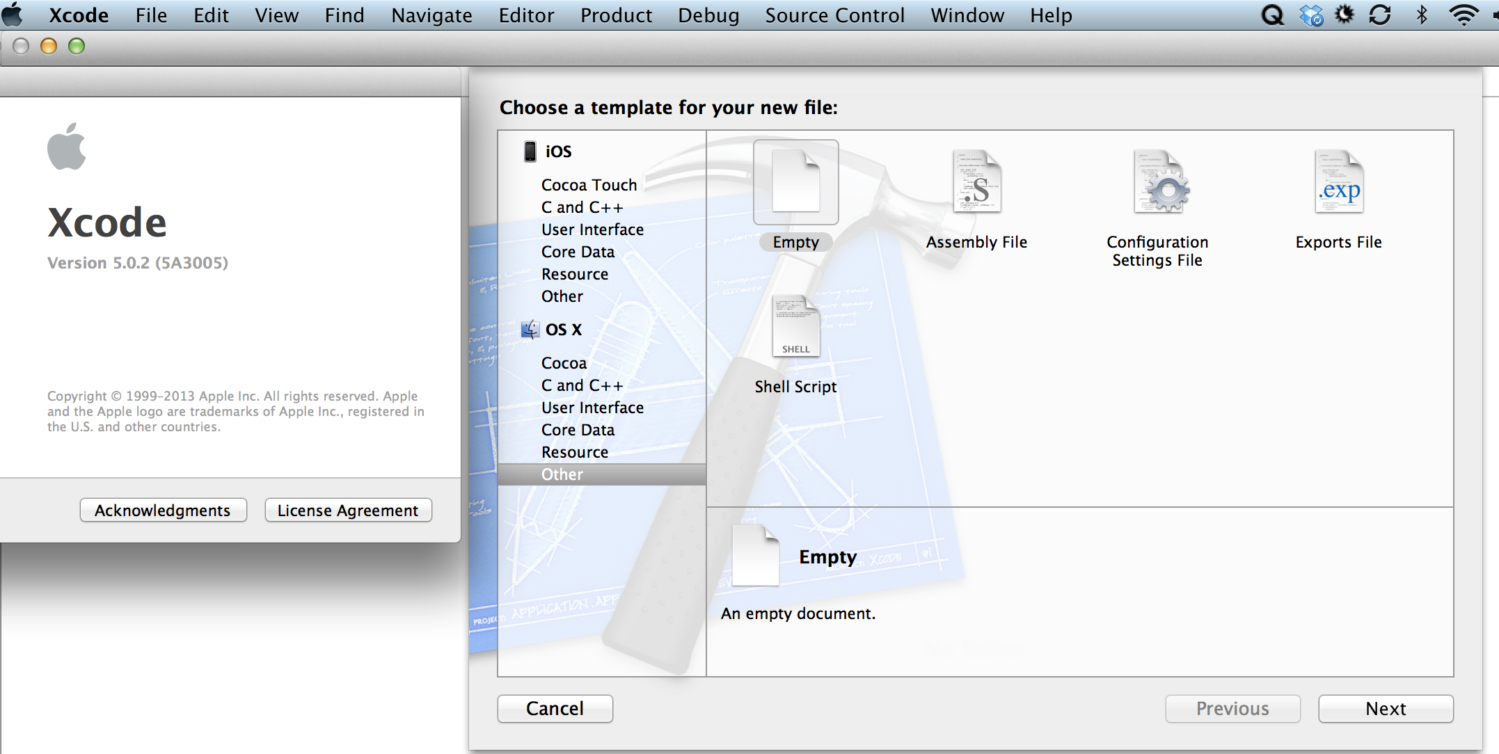

Here how the dialog after choosing create new project looks
i begin to understand that there maybe be a problem with the version of Xcode
i have an older version of Xcode on an older mac and the window for new projets look like your picture.
the question is, so : what model should i choose among the models proposed by Xcode 5 ?
That is strange. I have the exact same version of Xcode5. Freshly installed on my virgin nMP when it arrived - so no old baggage from old install left over.
Did you by any chance install some template packs?
Edit: I think I found the problem. What you have opened is the "new file" dialog. You need the "new project" for creating new projects. New file is used to add elements to an already existing project like additional classes.
thanks, for the time spent for me ! i was always afraid for very technical errors, and that was very simple indeed
