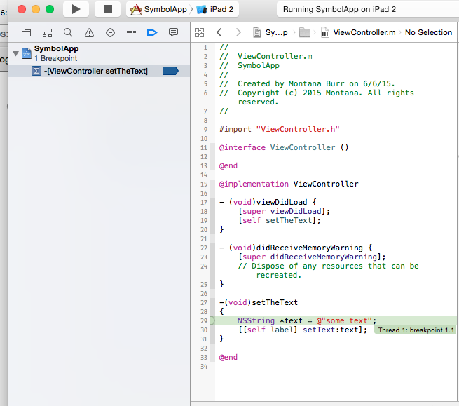

Edit: Here's a screenshot to illustrate what's happening. Note that this screenshot is not from the app I'm building - it's from a project I just built today:
Tlg0O1hCArXjHsGD5GZ3uU-c4BTduoyANQgNaoEtqzw=w655-h579-no

Update: Apparently, what you see in the screenshot is exactly what Apple wanted the symbolic breakpoint to do. However, there is a way to see the line of code in which a method was invoked while your app is paused by a breakpoint in that method. In the Debug Navigator, in the stack trace, will be the name of the method that caused the aforementioned method to fire. Click on it, and Xcode will highlight the line in which the method the breakpoint fired in is invoked. Here's a screenshot, from this related Apple Support Communities thread:
