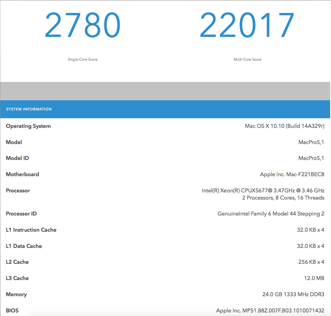

When I upgraded the last time, I wanted to put in X5687. But I searched all sources that I could think of, and could find no X5687 installations in a Mac Pro. Even Geekbench which has a very large database of CPU installations has no installations on a Mac Pro or Hackintosh. In the end I went with two X5677, they are working fine.
Note: The X5679 is a different animal, it's a 6 core, 3.2 GHz. I assume the OP, like me, was looking for the fastest 4 core CPU available that would work in a Mac Pro. The X5677 is it.
Lou

Just my two cents, I also installed dual x5677 processors in my 2009 and it's been great. I wanted the fastest possible clock and didn't require 12 cores. I went used off ebay, pretty cheap and no regrets.
I read online that "there might be issues" or "memory problems," but everyone I found who actually went this route has been very pleased. I rather suspect that they're just underutilized and therefore less is known. Best of luck with your mod!
Flowrider, are you still happy with your setup? Is there anything special I need to know about the X5677? Numbers look good.
Yes, if I had it to do over again, I'd do the same thing. I did have one small glitch. Of the first two that I got, one of them would not read RAM slot two, the vendor gladly exchanged it, and all has been fine. Nothing special about the installation on a 5,1 Mac Pro. You, of course on a 4,1, will have challenges I didn't have.
