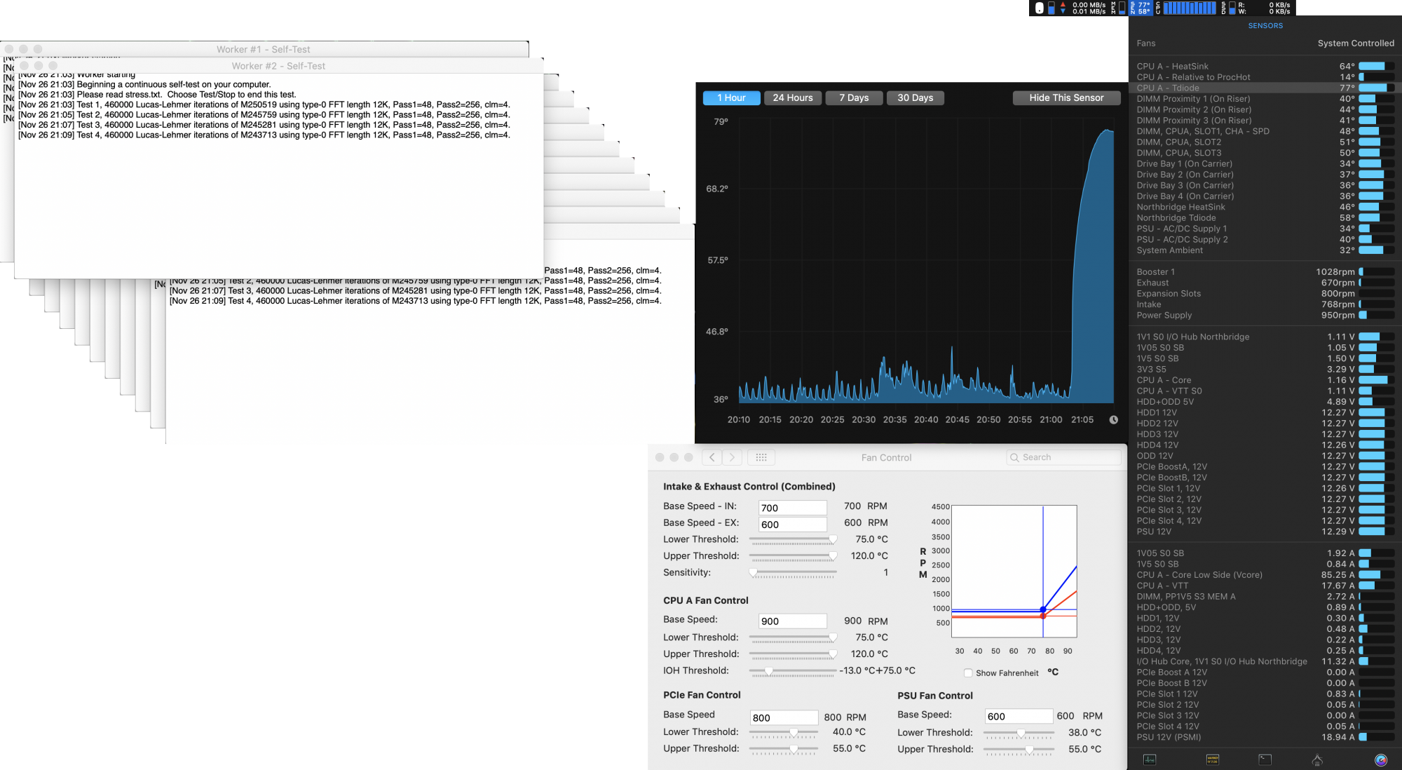

Could someone with an X5690 in a single-CPU Mac Pro 5,1 do me a favour and tell me what peak temp you hit while running the Prime95 torture test (ideally with hyper-threading enabled)? Thanks!
For temperature comparison, you need a full picture (e.g. ambient temperature, and fans speed, etc). Just comparing the max temperature has little meaning.
If he don't mind to use W3690 as reference, then I've done this test before, and has the record
