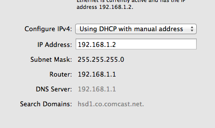

On the problem MBP, how is it set to configure IPv4? Using DHCP (which it should be) or some other method? You may have settings issues on the MPB. You could always delete the interfaces in network settings and re-add them. I guess you could try matching the settings to what is working on the iMac.

I matched the settings on the iMac exactly on the MBP with both in booted into 10.6. No go. The weird thing is that I AM getting an IP for the MBP from the router, but at the router's config page it does not show up as a connected device and of course, I still have no internet.
When you are connected, but not able to connect to the internet, does it give you a dns server and a search domain? Sounds like for some reason the dhcp server on the router is not giving you all of the information you need. I'd be willing to guess that when you connect the router gives you a 169.xxx.xxx.xxx IP address?
Just a hunch, is the router able to broadcast on the 'n' band? What Macbook Pro do you have?

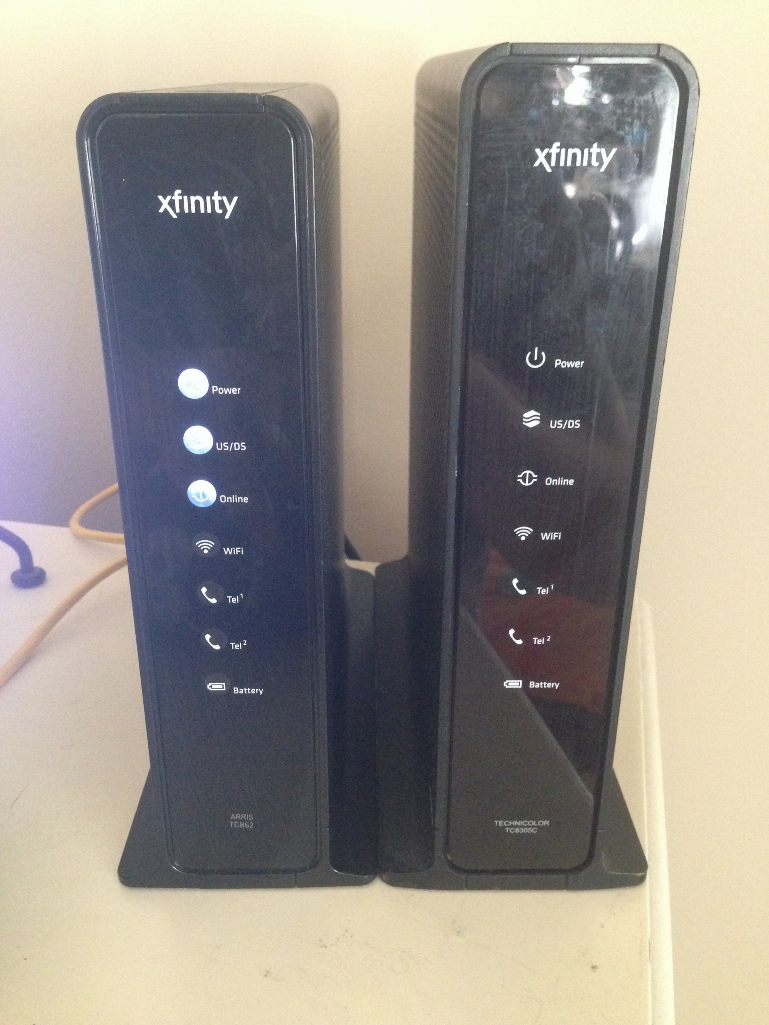

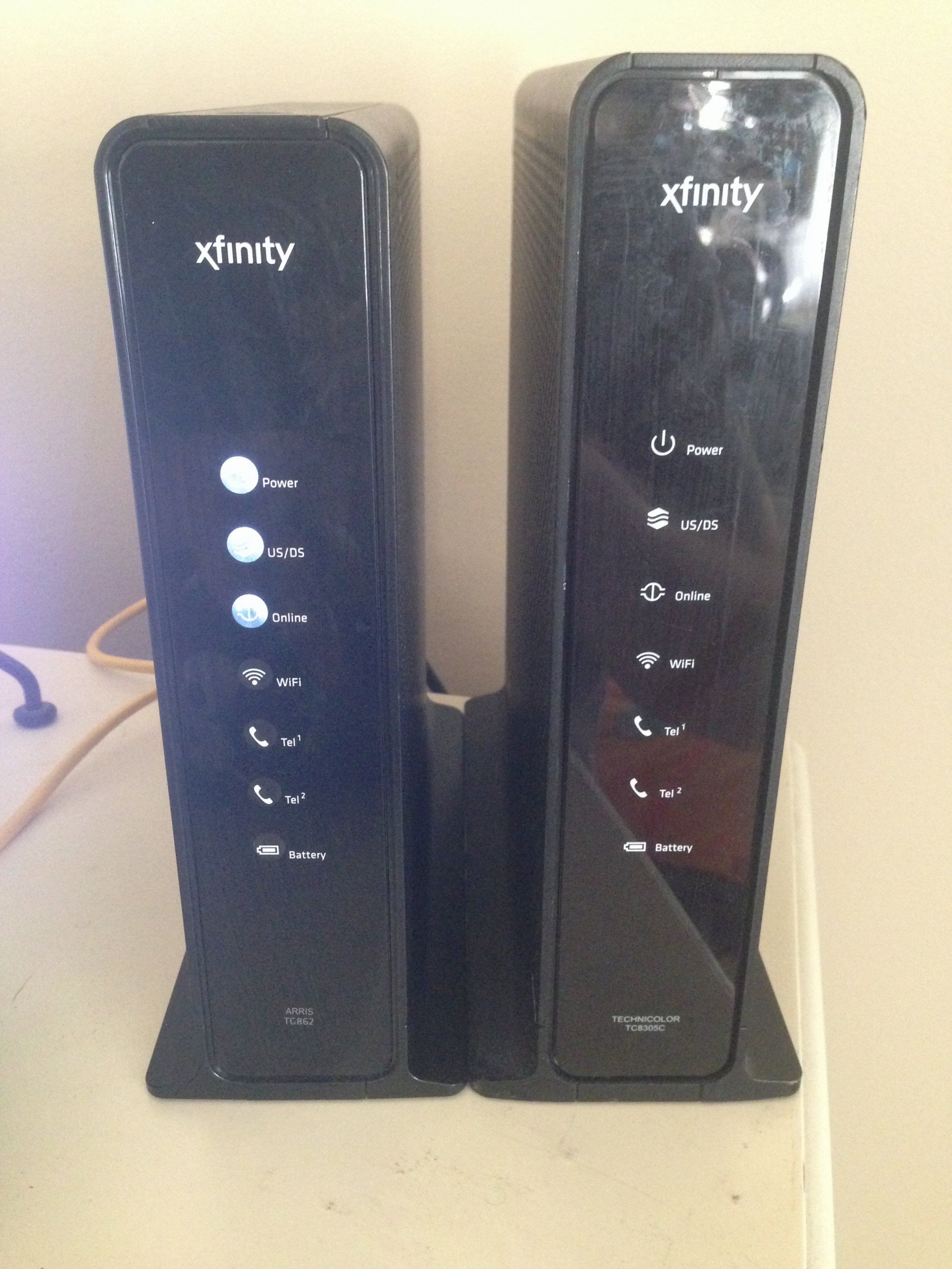

I have had the same problem, it is a certain modem/ router that Comcast uses. As far as I can tell the arris routers do not work with Mac. My old xfimity router worked fine and we just switched service, now the new one doesn't. The router one the right works fine, I will be switching them out asap.
