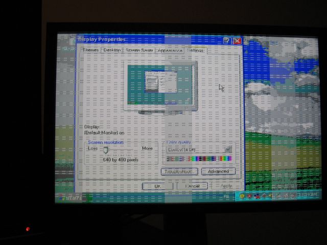

I booted into Windows with the 4890, but the image was unusable--to the point of not really being able to successfully navigate to try to fix it. I took a photo and attached.
It's been a LONG while since I've used Windows, but perhaps I should be booting into safe mode? Is this possible in boot camp?
Could this be a dirty power issue, and perhaps I should wait until I get the proper cable?

Oh, I thought you had flashed it using the ATI tool in OSX?
If you have not flashed it yet then the card has a problem. Was this a new card?
No, I had only loaded Natit with the 4890 out. I could never get the machine to boot past a blank screen with it in; consequently, I have not yet been able to try flashing it.
