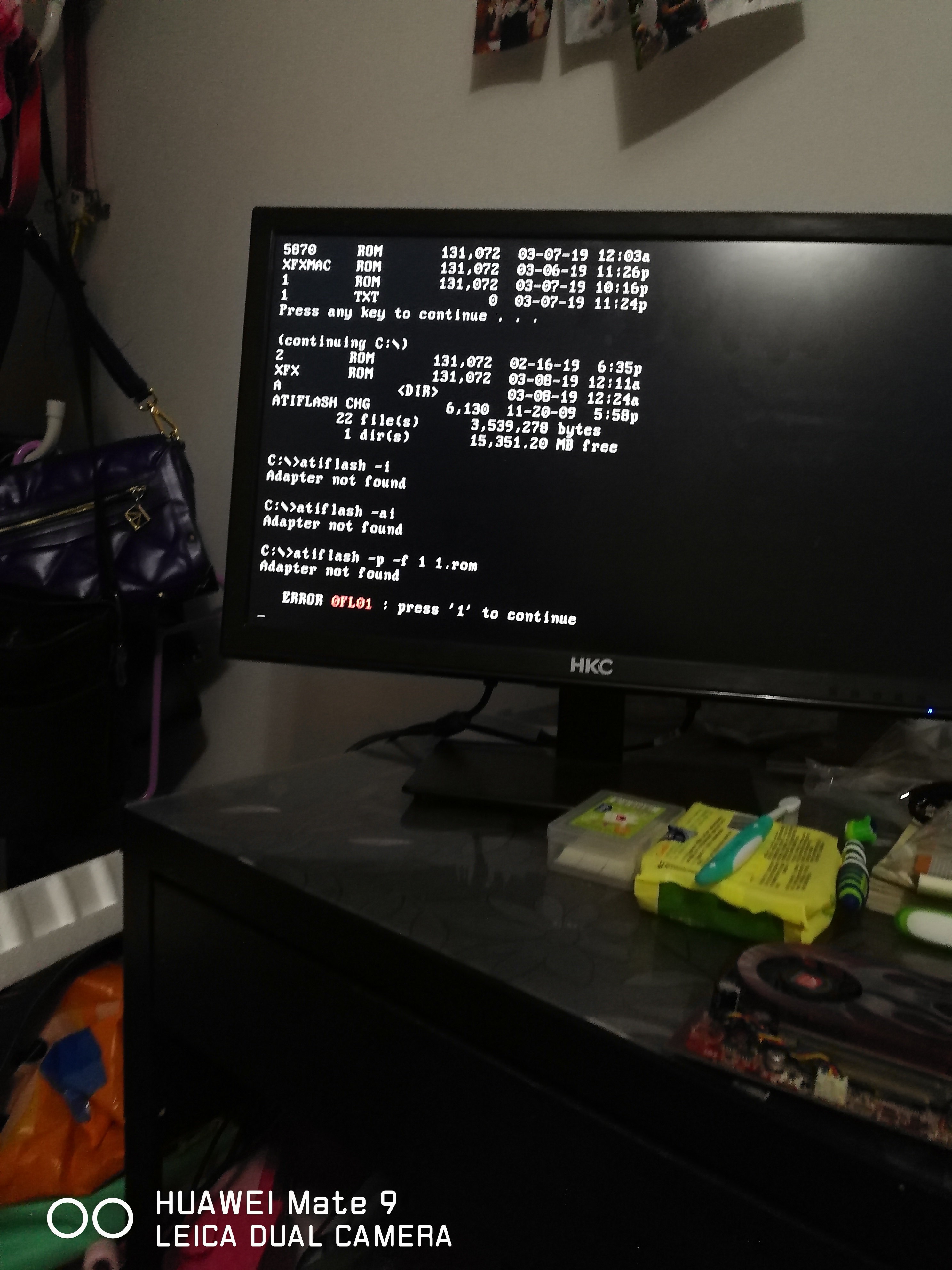

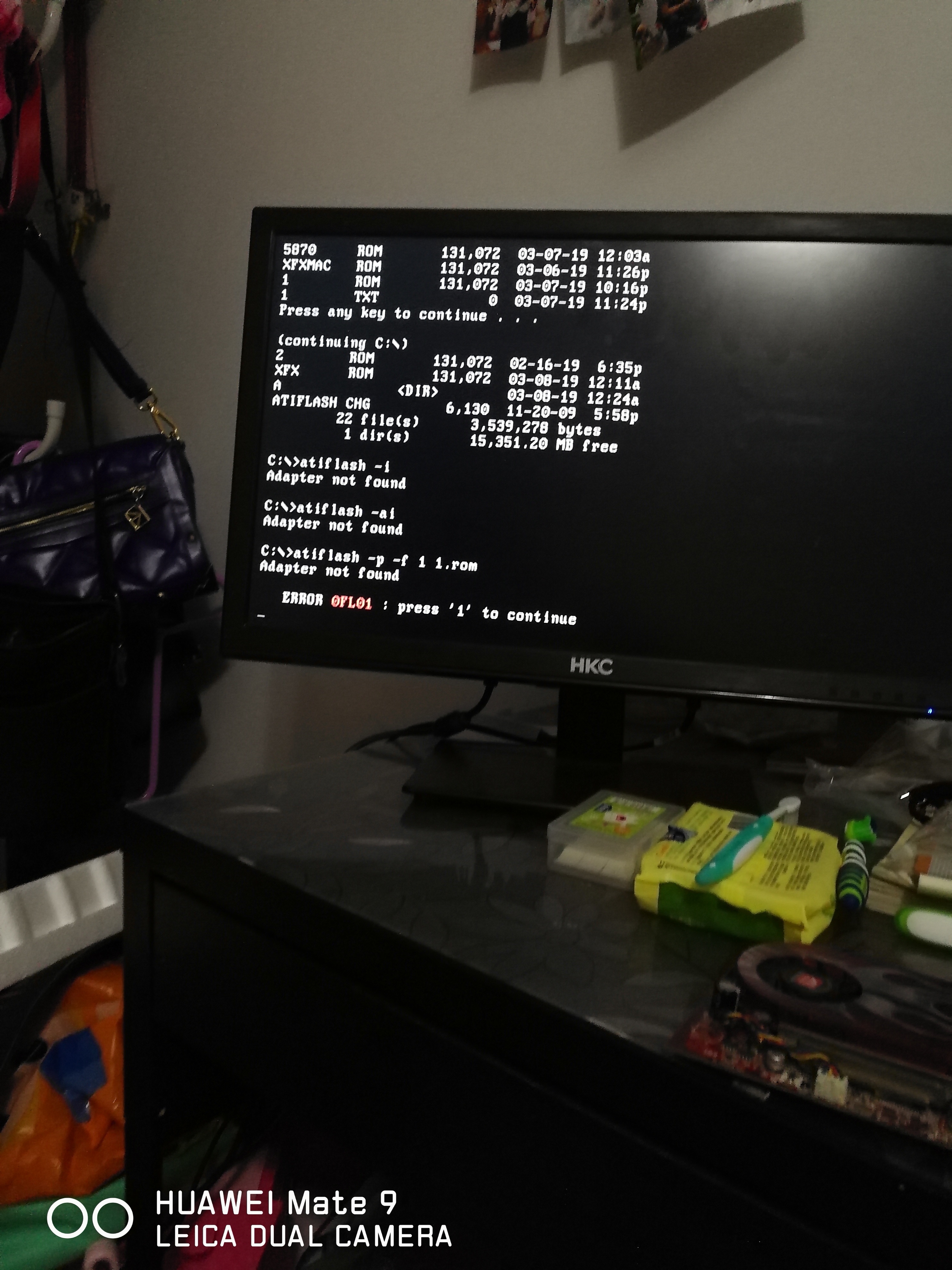

My XFX 5870 Brush mac EFI Brush the wrong bios, boot fan turn, graphics card heating. Using the dual PCIe motherboard, the main PCIe gt730, the sub-PCIe xfx5870, using atiflash-p-f 1 1.rom, there is a 0fl01 error, press 1 to exit.
Can someone help me?

So if you try booting to the atiflash USB with only the AMD card can you see anything on the screen?

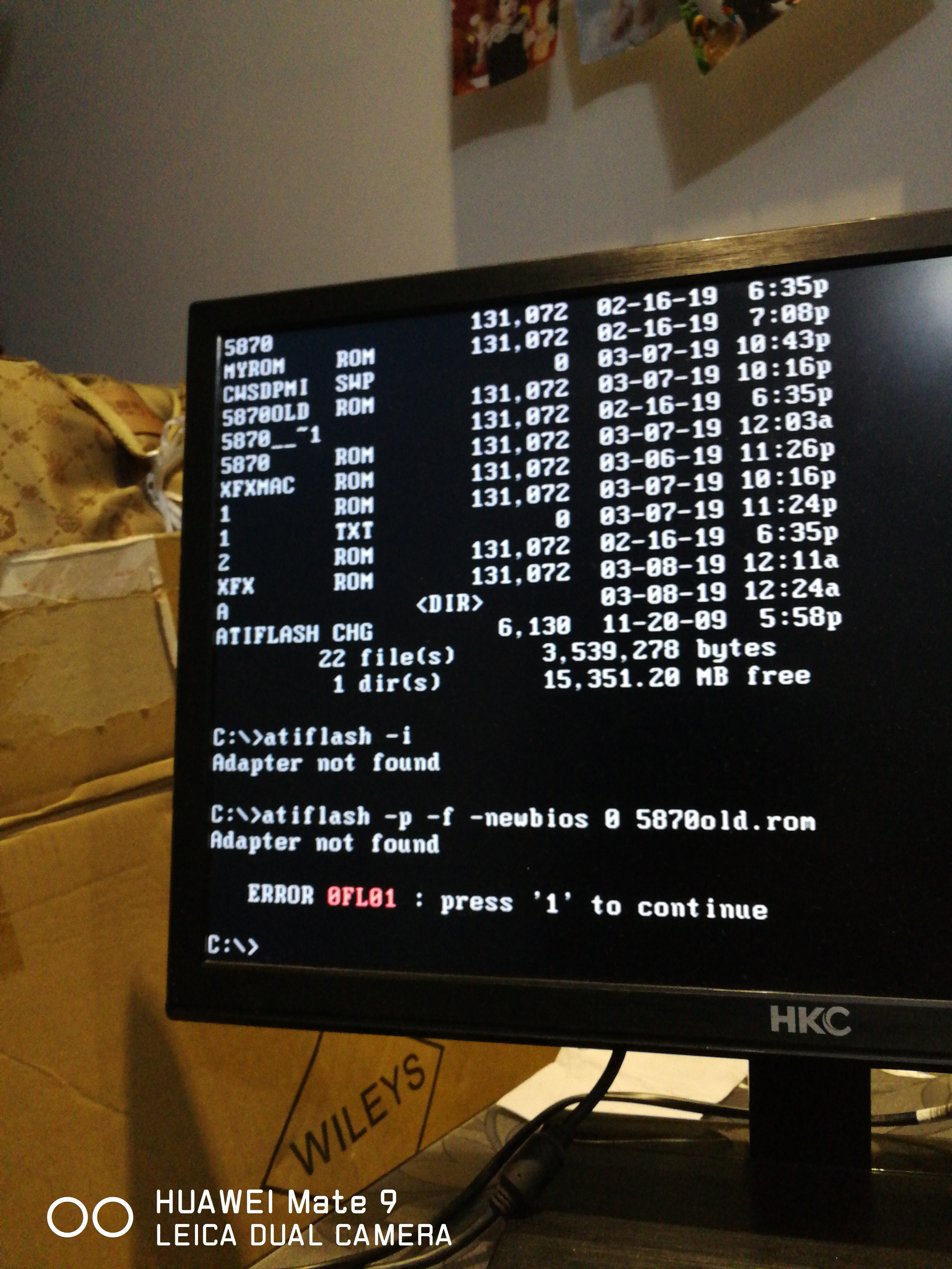

I have a PC with internal Intel graphics, which I set for only booting card in the BIOS and put my bricked AMD card for flashing before starting. After I boot I use Atiflash "blind/forced" flashing
I use the integrated graphics card of the G41 motherboard, the bad graphics card placed on the PCIe slot, the monitor connected to the motherboard integrated graphics interface. Using the Atiflash-i or-ia parameter, the screen shows that the video card cannot be found. Forced use of atiflash-p-f 0 5870old.rom. The screen displays a 0fl01 error。

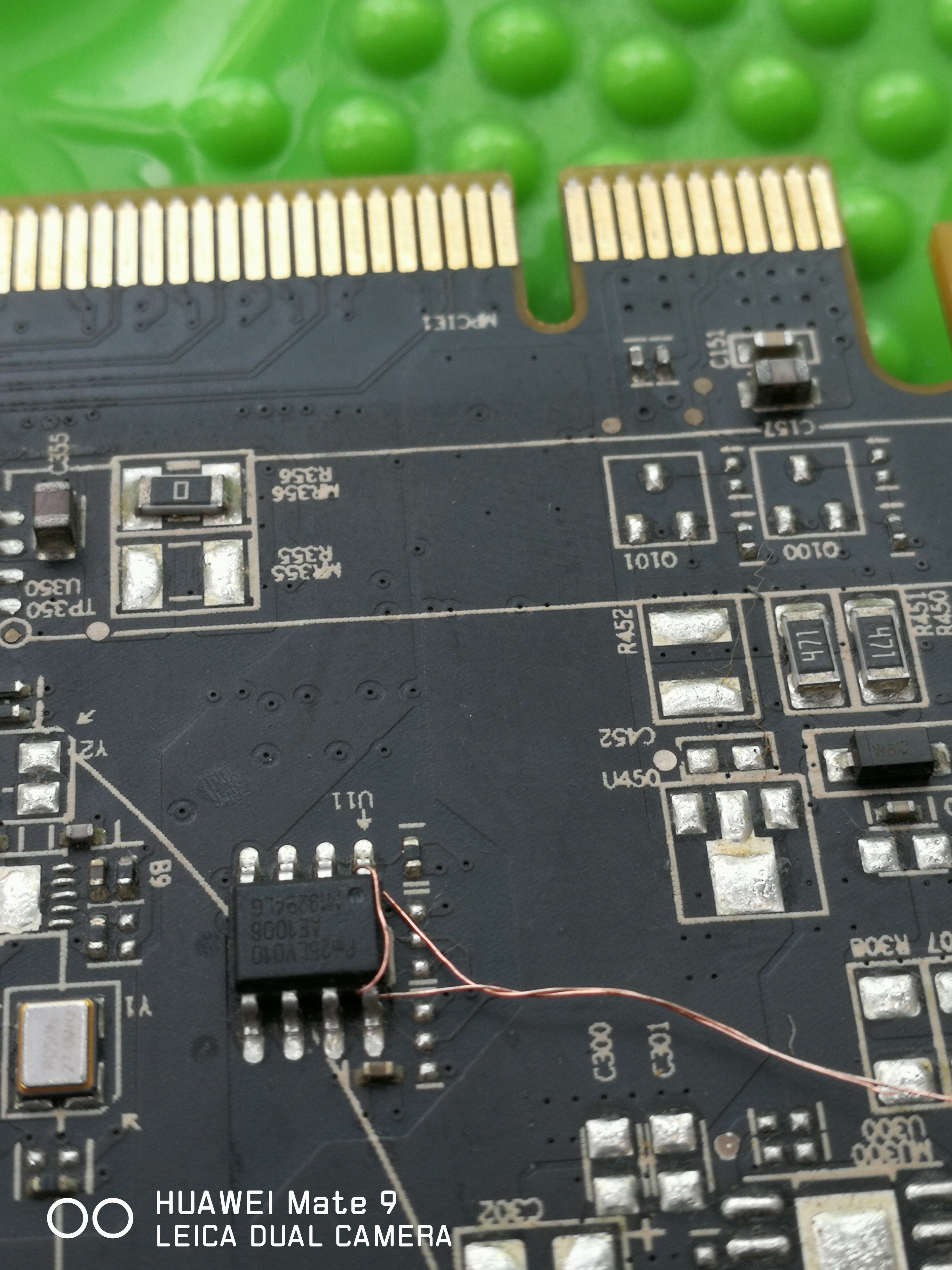

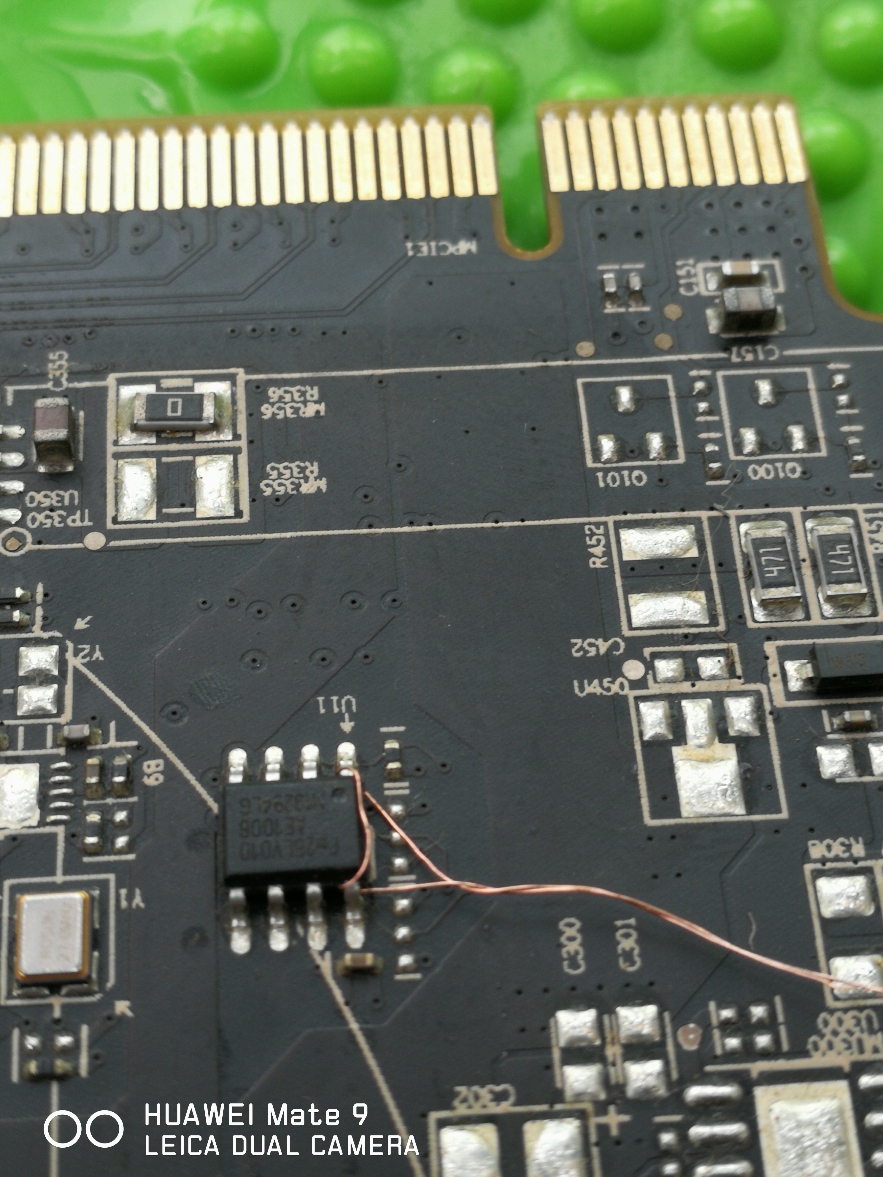

It will work with all add-in-cards with spi-flashrom, because this trick suppresses reading the rom-content. It is recommended to solder a wire to pin 5 and contact it to GND.

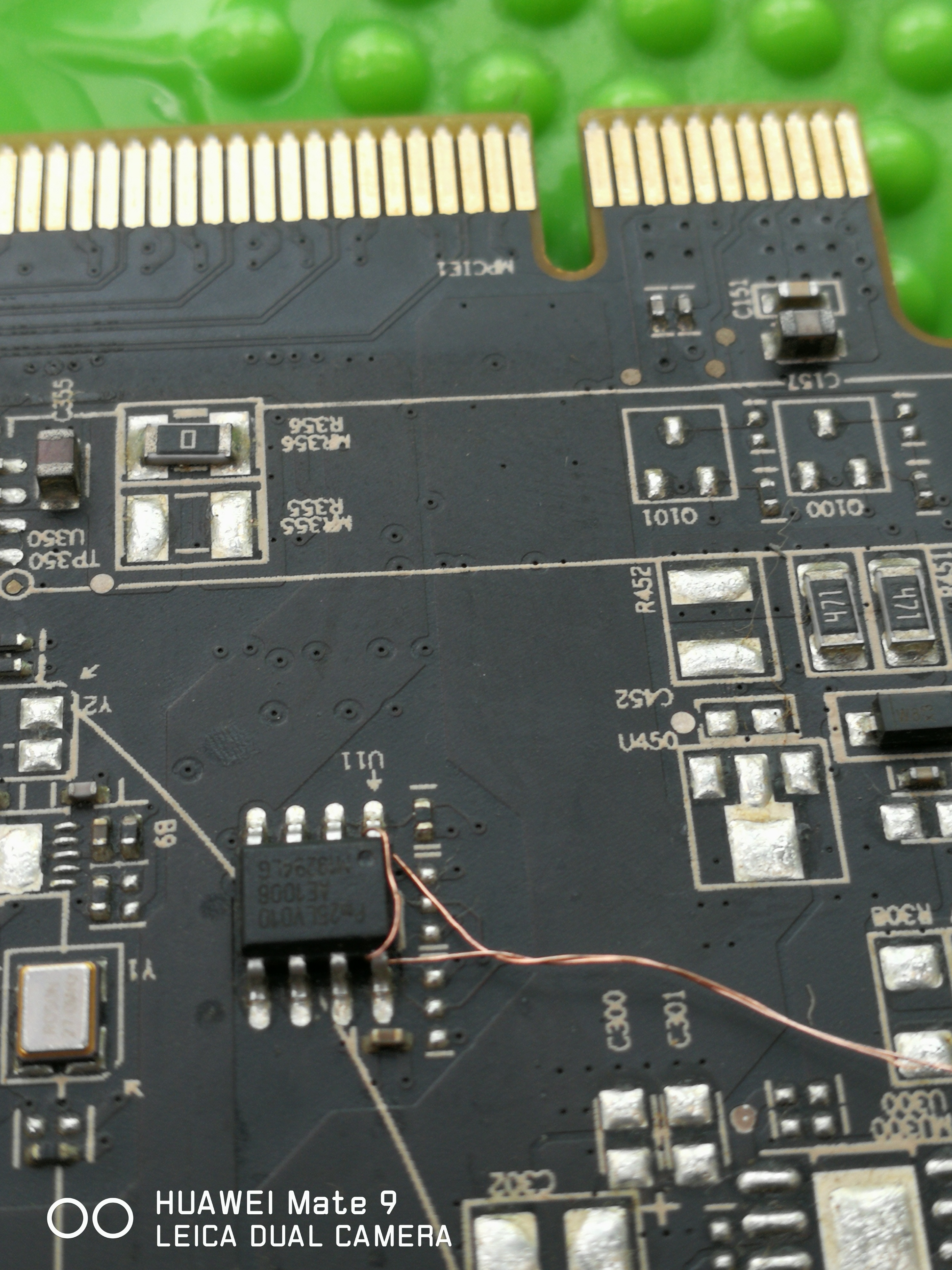

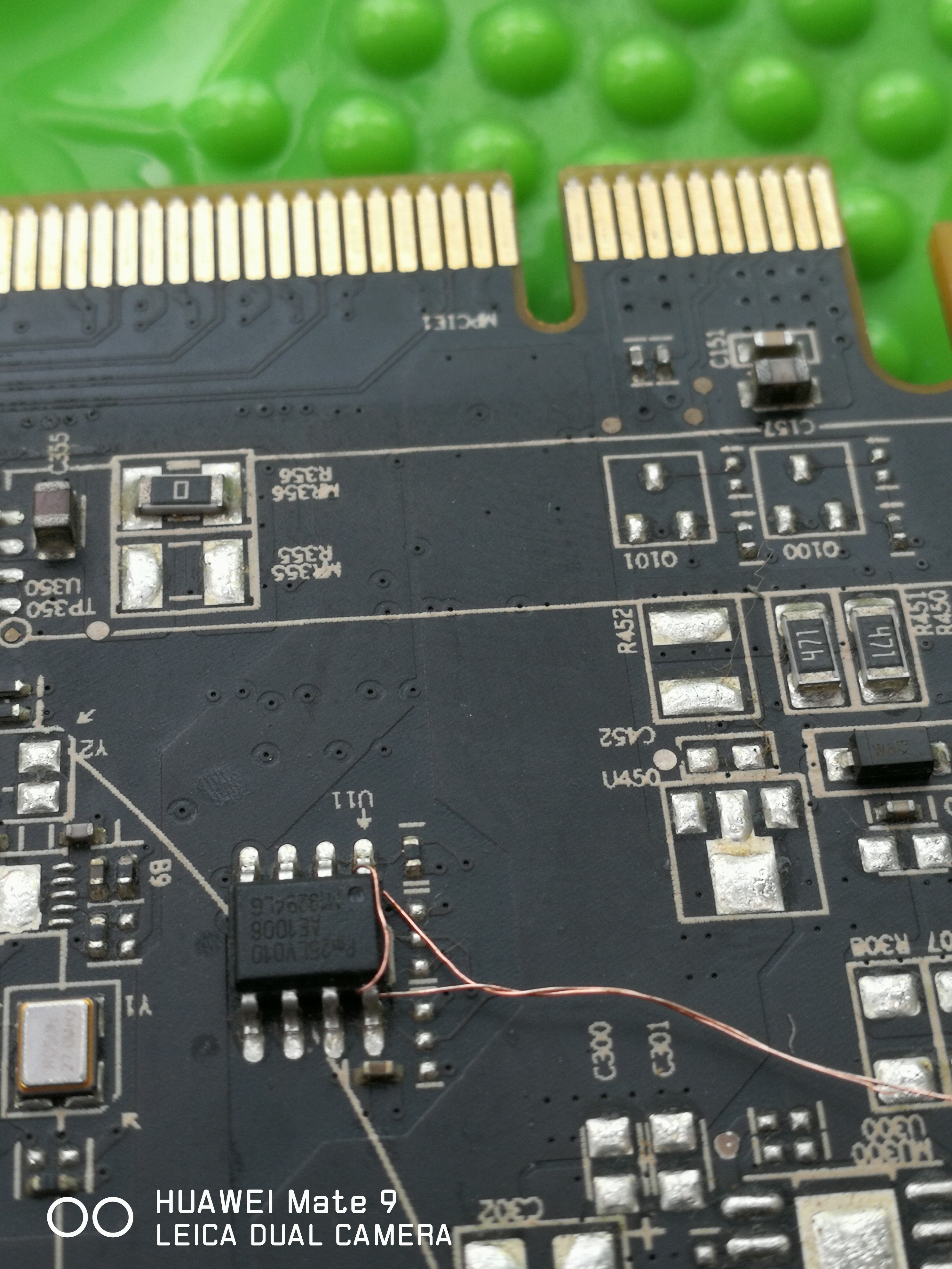

I used a very fine copper wire to short the Pin1 and Pin8. However, the device is still not found using atiflash-i. The same I short pin4 and pin5, the same unable to find the device. How is this BIOS chip pin1 to Pin8 defined?
