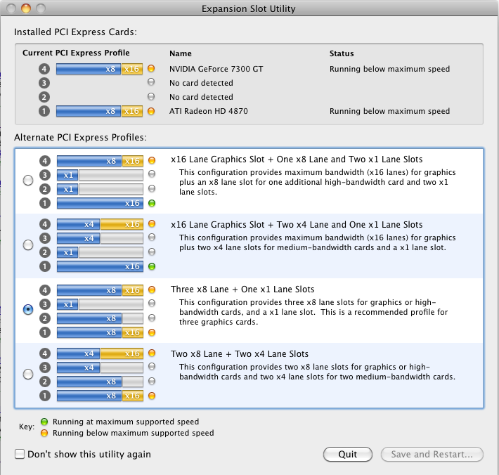

I flashed this card about 5 months ago and although it works ok, It does not run@16X speed. I wanted to know if there is another rom that can address this issue.
I have tried every slot in the Mac Pro in terms of slot placement, I have also used the expansion slot utility and nothing works. I also installed the same card with the original rom in my windows box running vista and it works at the corrects speed so I know its not the card. I have included the original rom that
came with the card.
I would appreciate any suggestions or help.

uhm, maybe cause you have to select the top alternative?

I appreciate your quick reply, but as I have said I have tried every configuration, as such if I chose the top alternative it wont boot with the card, again I have tried every slot and also every setting in the expansion slot utility
some settings in the expansion slot utility will not even allow me to boot the computer, I have to take out the XFX card and just leave the Nvidia just to boot the computer.
In addition to not being able to boot the computer depending on where the Card is physically in the computer if I change the setting in the expansion slot utility sometimes
the card is not recognized at all and the computer boots reaaaalllllyyy slow only on the Nvidia card.

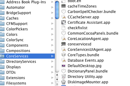

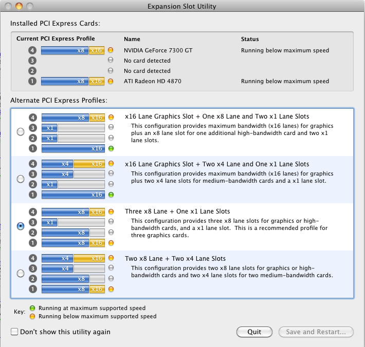

try this
insert only old nvidia (bottom)
boot mpro
open Utility (sys/lib/coreservices)
set to top alternative
reboot
if boots fine, open util again to see settings are correct
if correct, shut down, remove nvidia, insert only 4890 (bottom slot ofc)
try boot
try this
boot mpro
reboot
try boot
Cindori,
I don't know
how to do the ( set to top alternative ) I would appreciate your help.
