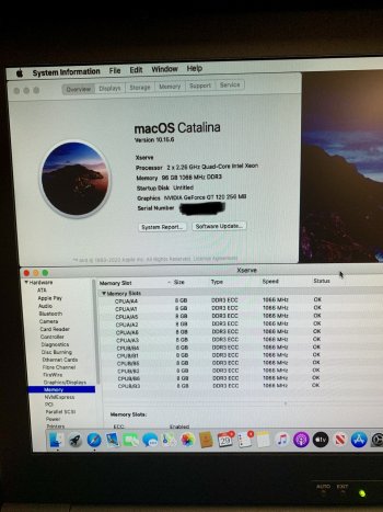

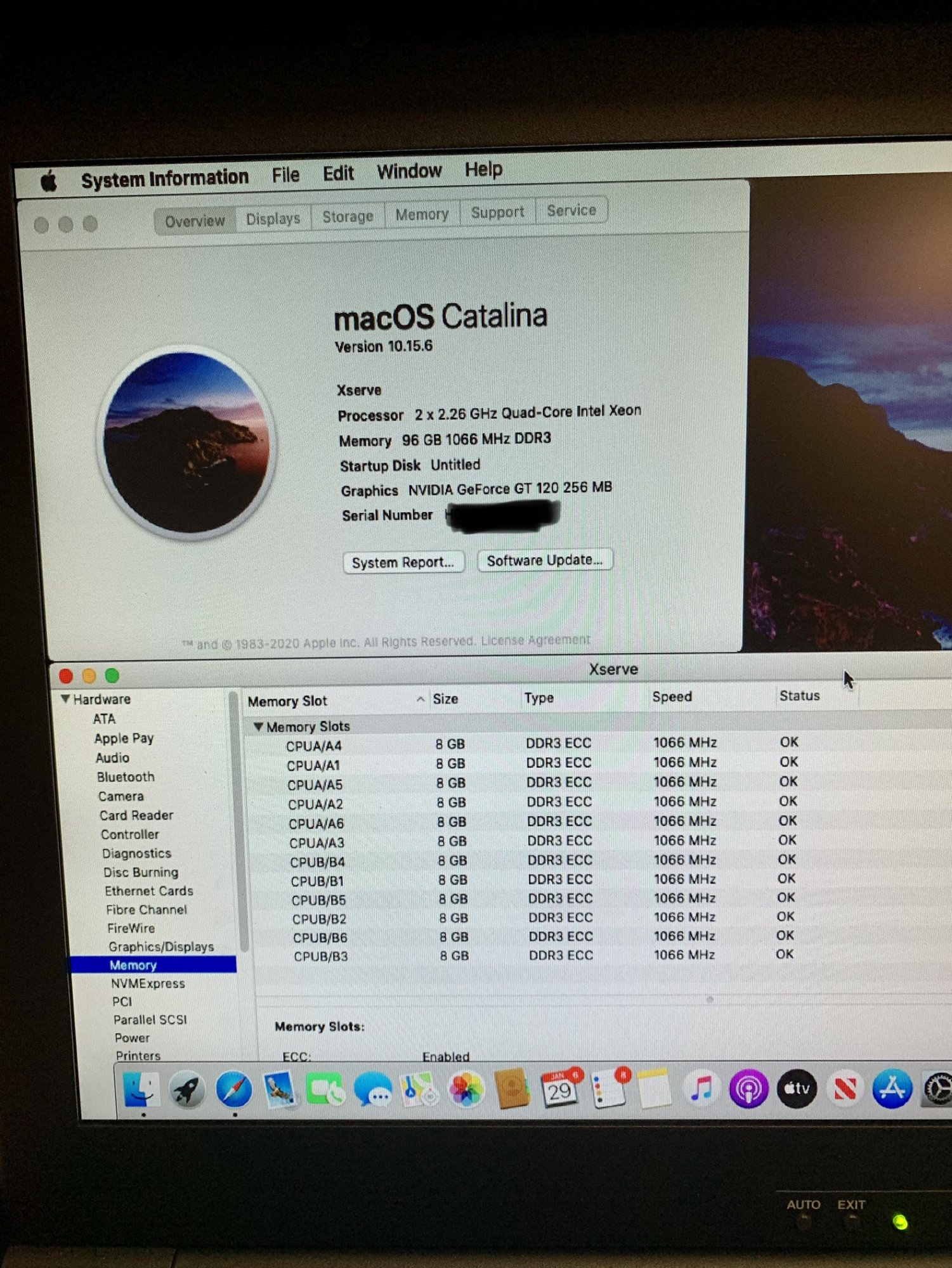

Hi all,
Just set up my first xserve, dual 2.26, loaded catalina through the dosdude patch - worked like a charm. Filled all slots with 8GB ddr3 PC3L, and all are recognized. Averaging around 3 minutes boot to home screen, so I'd like to get SSD's in there and try it. Intel 82574L ethernet controller and LSI Logic LSI7404EP Fiber Channel cards installed. Full support for iMessage, iCloud/backup, even SIRI!
