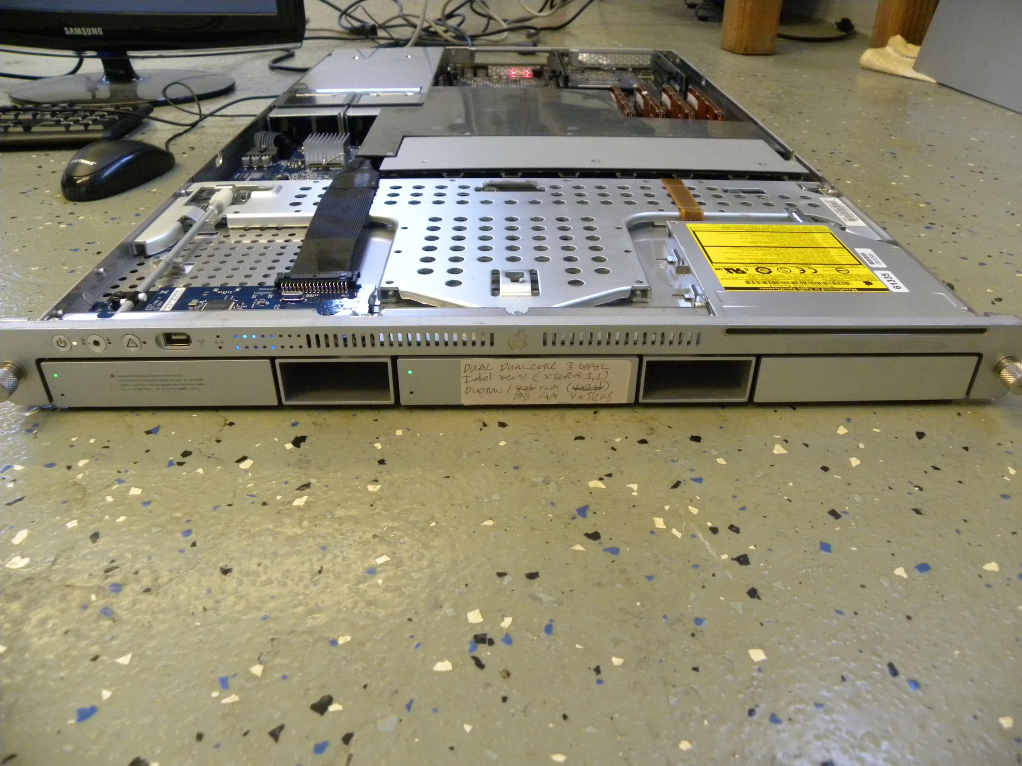

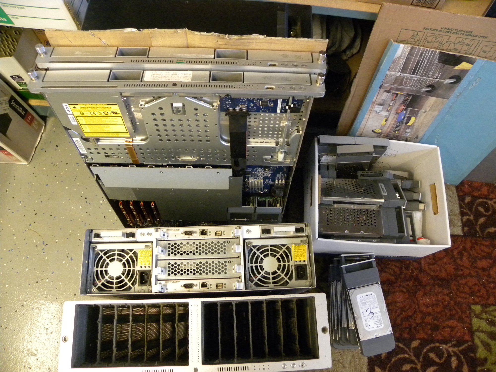

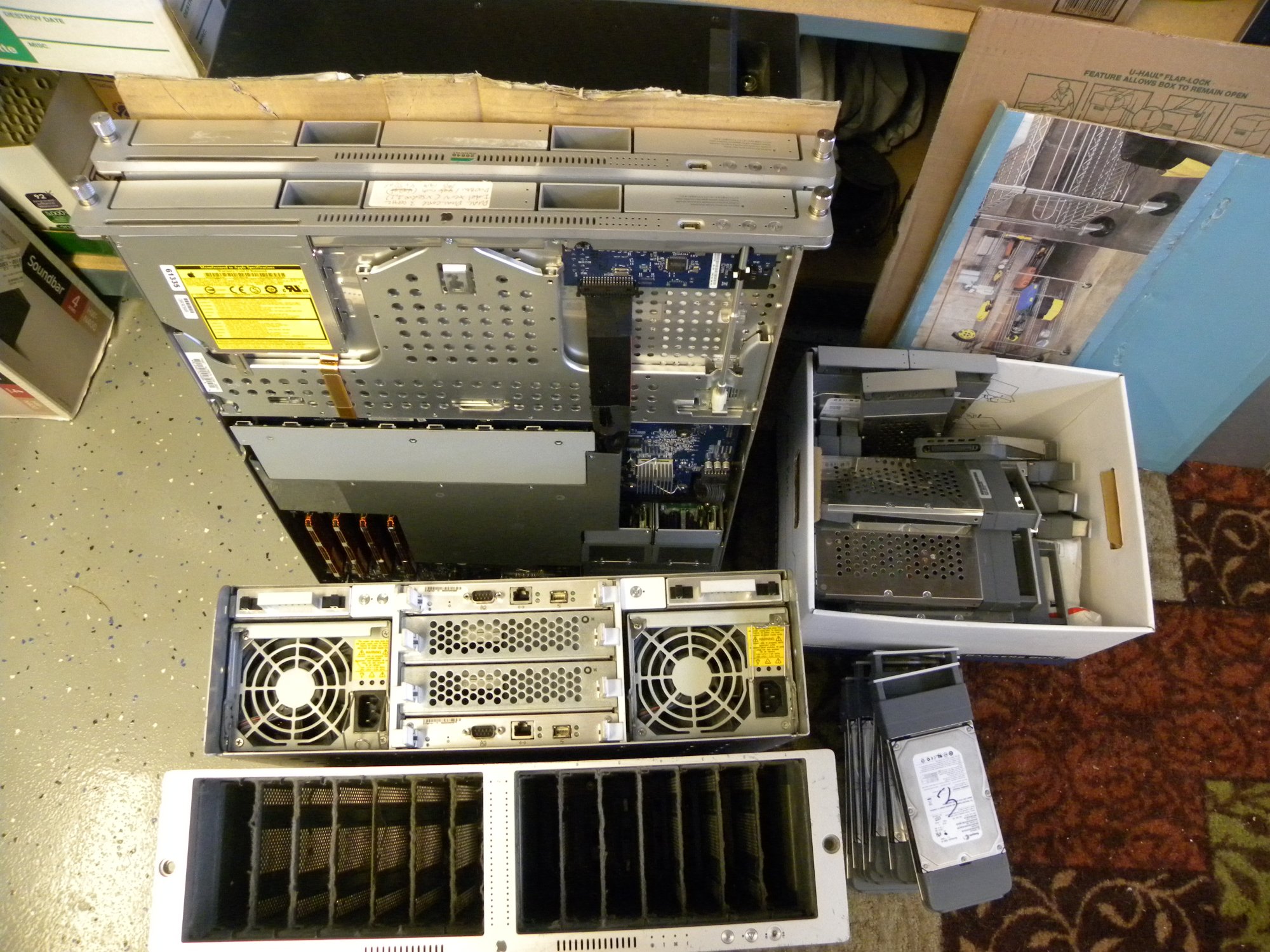

A friend gave me 2 blade, and 2 rack HD XServe units to refurbish and test. Please see the pictures. I know absolutely nothing about these. I do not know anything about servers except what they conceptually do.
2 units are A1009. I have all the drives, but pulled them out is see how bad the dust was. The 2 blades have no obvious model numbers I can see. Those have 2 of the 3 HD bays filled and 2 I/O units each on eh back side.
So how should I proceed? first blow out the dust. What are best practices for this on a server?
How to connect them to a keyboard and screen. I do not have any Mac computers. (well I have an Apple III, and a Lisa 5/10 I'm working on) I'm a PC guy. I can build a high end gaming PC with my eyes closed, and solder in new ram chips on to an Atari 800XL no problem. I know a lot, but not enough.
These units have been on a shelf in a Public Storage for several years. No apparent damage, no rodent, or insect problem. The one HD rack showing with no drives has some rust around the fans at the back.

From the photo, it appears you have 2 G5 XSERVE rack mounts which run older Mac OS (not current Intel).
You also have 2 RAID systems.
Servers are just like a regular Mac machine - they can be configured as such....
If you don't have another Mac that has Firewire port (peer target display) connection, then you would need to connect the server to a monitor using the Mini Display port - you can get an adapter to VGA or DVI inexpensively on eBay or Amazon.
Find out if it boots and how much RAM is on board.
Run Apple Hardware test CD ( I have tons if you need) from the optical drive if it won't boot to OS.
Then if you want to run an OS, find an old PPC Mac OSX cheap but the maximum OS is 10.5 Leopard.
Based on how old these are and the limitations on running a current OS, it might not be worth much in the US. You may find a buyer outside the US but the costs to ship will be very high.
I had a rack of these older G5s a long time ago that I kept alive but now I use an Intel Quad Core XSERVE 3,1 for my office closet as a network Time Machine.....

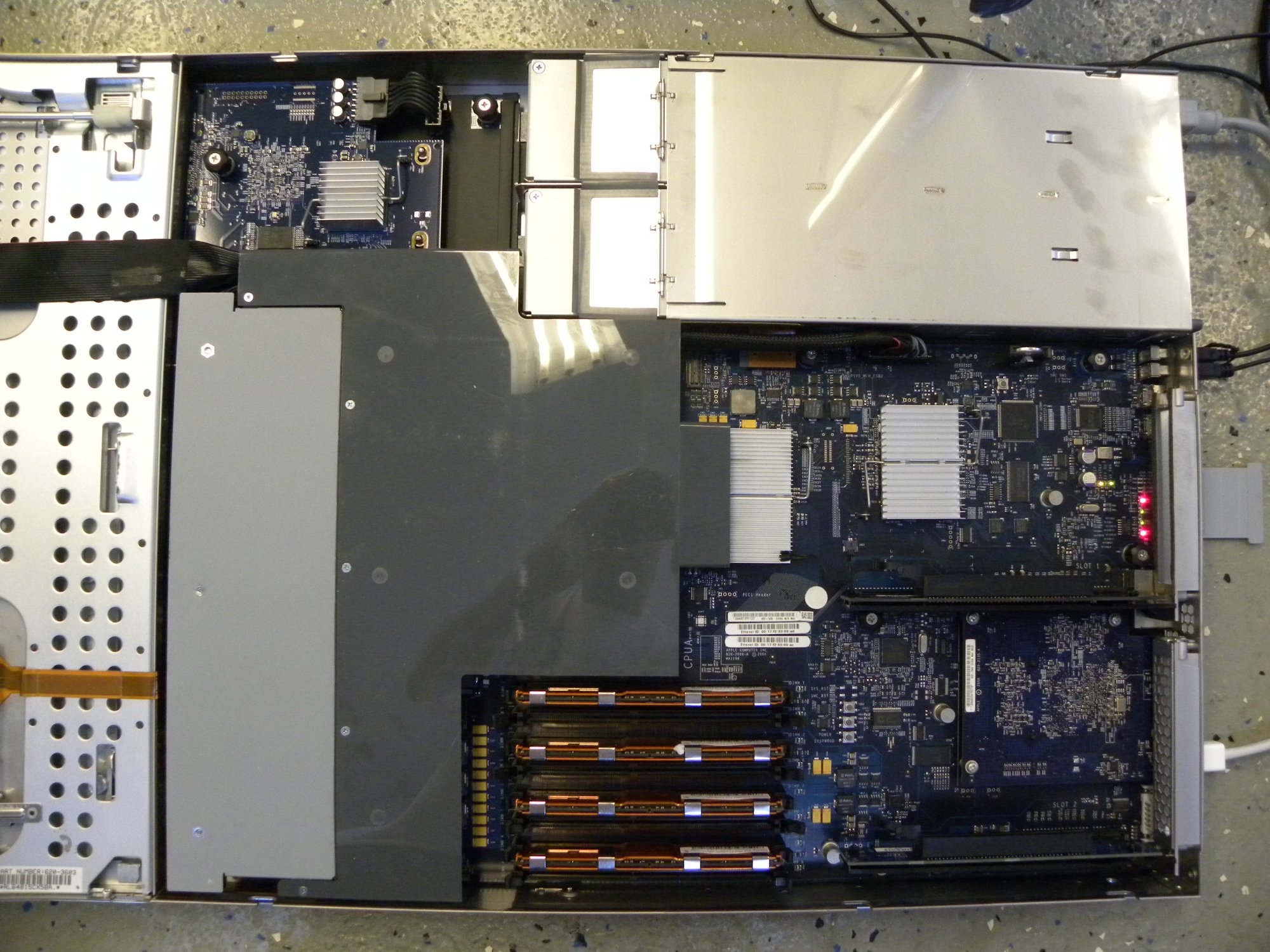

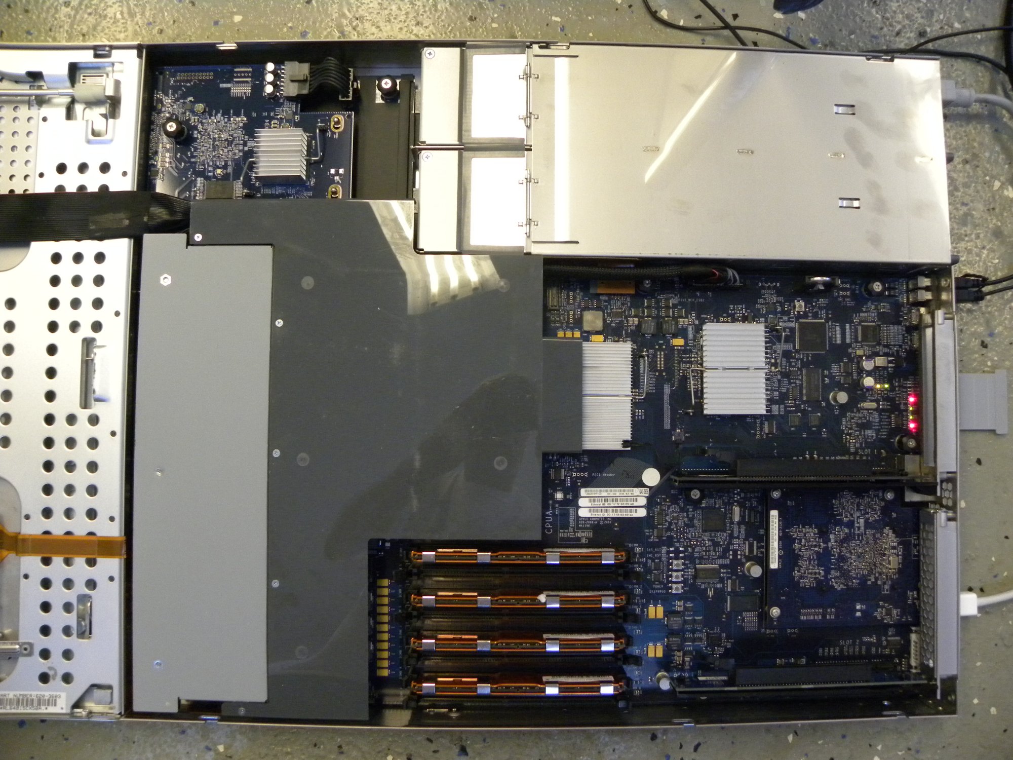

Post a picture of the RAM stick detail or CPU assy # off the logic board so that I can see exactly which version you have (Power PC or Intel).

I think I have 2006 versions. Mine only have a mini-DVI video, and are stocked to PC2-5300 ram sticks.
I'll post a pic a few hours of the main board.

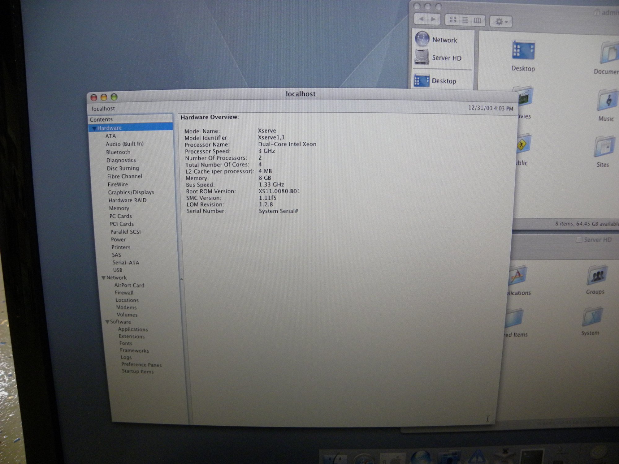

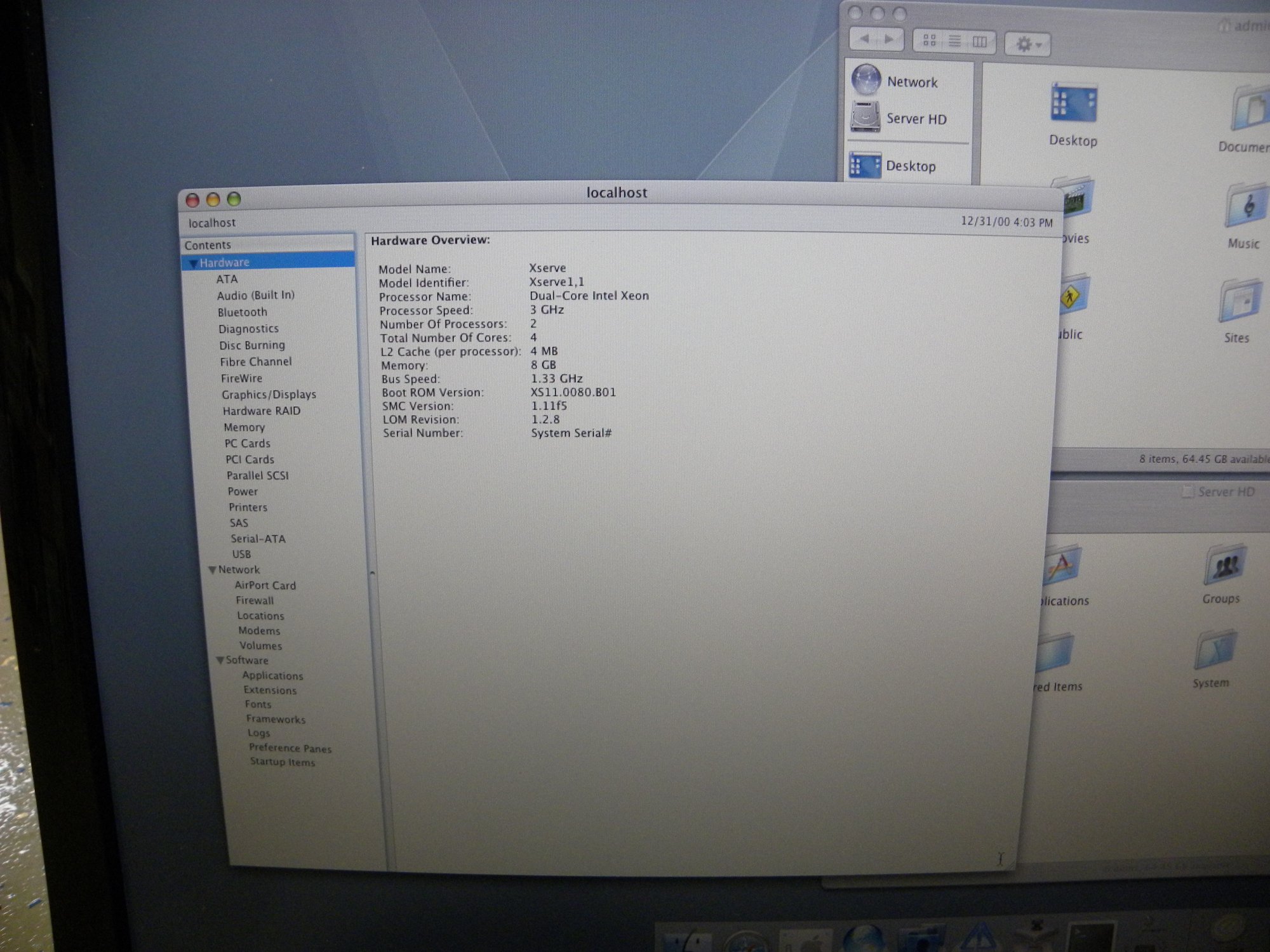

Zooming way in on the label on one of the servers, I believe I see what says "XServe3,1." (It's hard to tell, given the photo.) If so, that is the model identifier and it is most likely the XServe 2009, which was the final Xeon model.
Your photos will help identify it and we can advise from there on what software you can use to get it running.

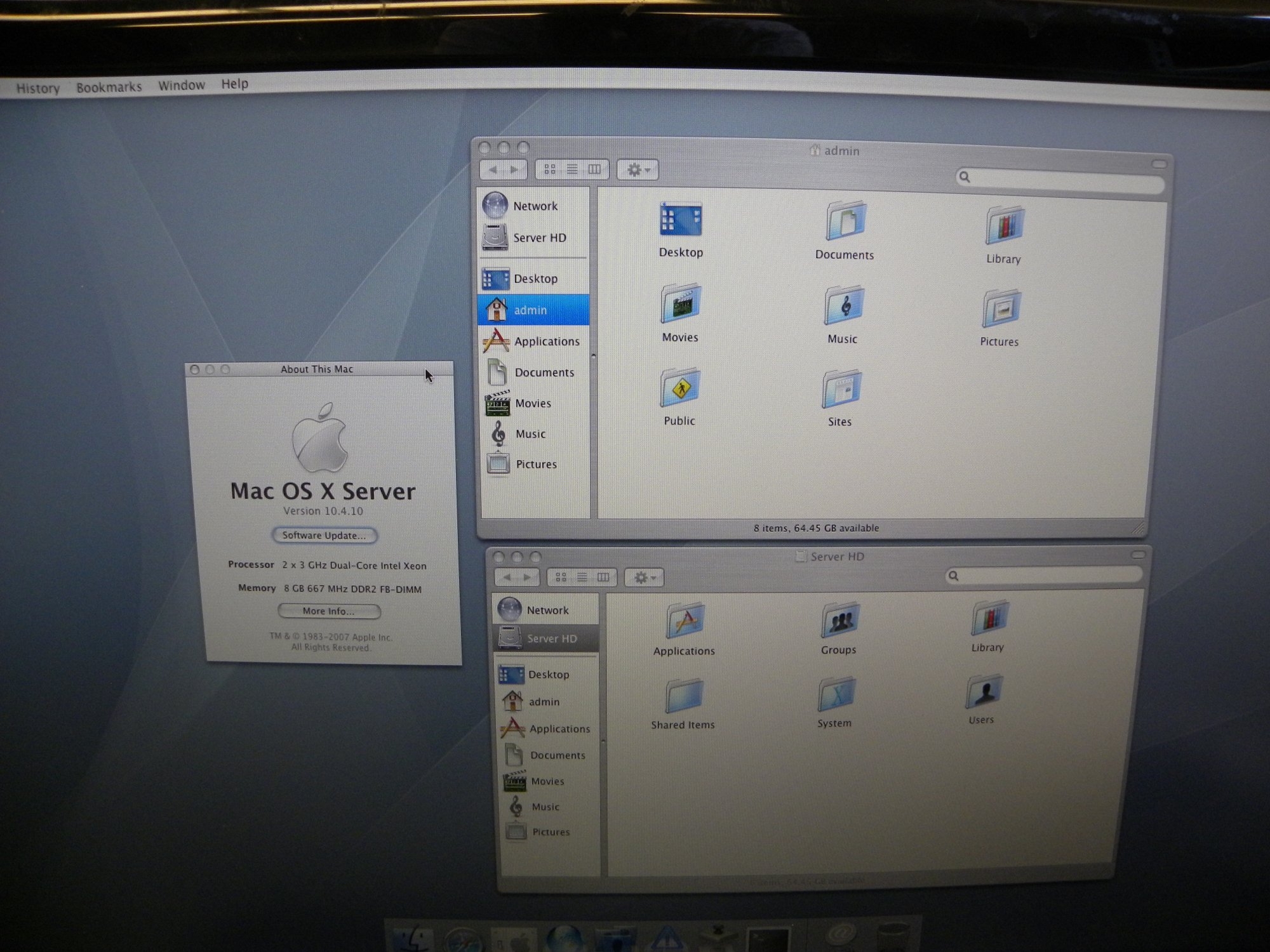

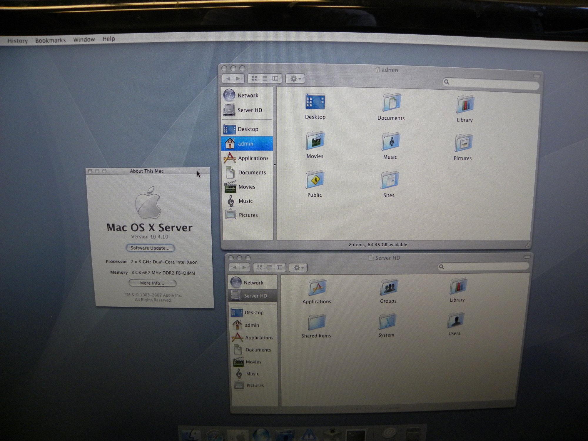

I was able to get one of the Xserve's up and running. You can see what is it from one of the attached pics.
Now I would like to check the RAID units. I connected one to the server with a Ethernet cable. But i have absolutely no idea how to see it from the desktop.
Again please note, i know very little about mac os. point and click is about it. but what to click...I have no idea. I have never owned or used a mac, sorry.

Cool. According to this, you are running the OS it came with (10.4), and this model can be upgraded all the way to 10.7.5. Gives you a little more options to run less ancient tools, as it is Intel and not PPC.
Also good news....10.7 is the first OS where Apple broke the OS out from the server tools. With 10.6 and older, you needed a serial for the Server OS. For 10.7 and later, the OS is the standard free (no serial) as the desktop, and the Server features were an add-on that was a $50 purchase, with no serial as I recall.
RAID: It has been years, but as I recall, for data (to mount and access drives), you need at least one Fibre Channel cable. The ethernet is for remote management only, no data.
To configure the XRAID, you need the XRAID software, which is a separate optional install as I recall....or is it installed in the Applications/Utilities folder? Can't recall. According to this, the RAID admin tool was installed with Server....so dig around for it in Applications or Utilities.
Here is a pretty good guide to use the RAID tool, once found or installed.

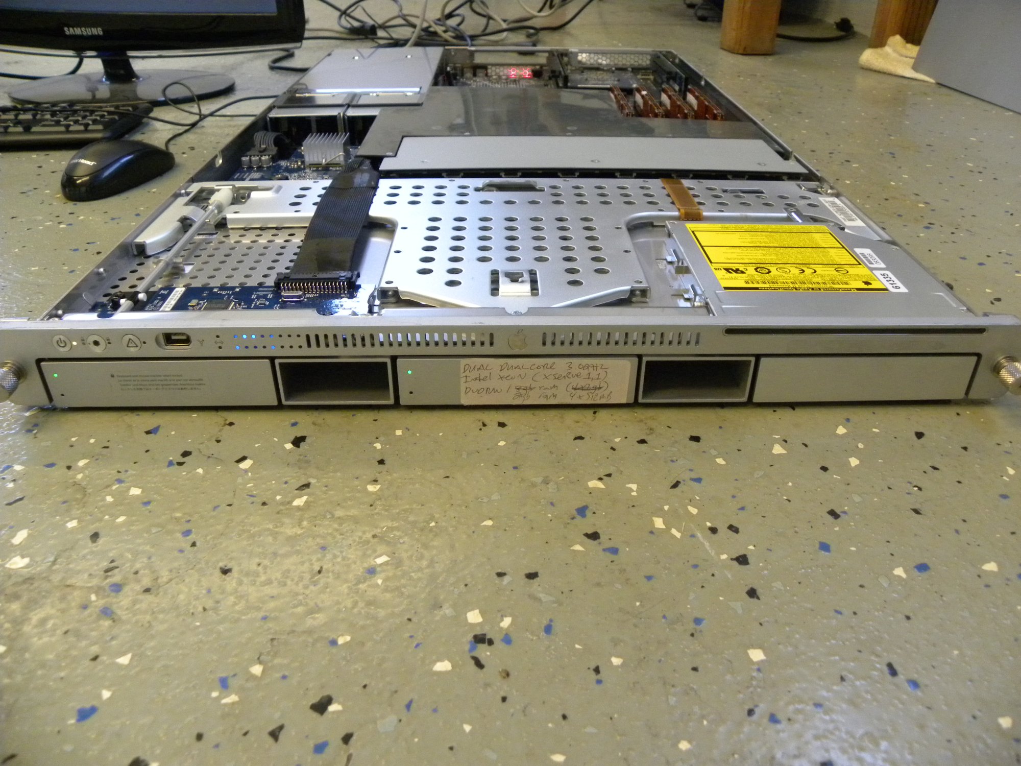

I realize this is an old thread, but I would love to have a close-up picture of the label on the left Xserve drive tray. I imagine it is something regarding the mouse, keyboard, and drives when the lock is activated, but haven't been able to find a legible image of one.
It says "Keyboard and mouse inactive when locked." then in French, German, and Japanese on the other lines.
