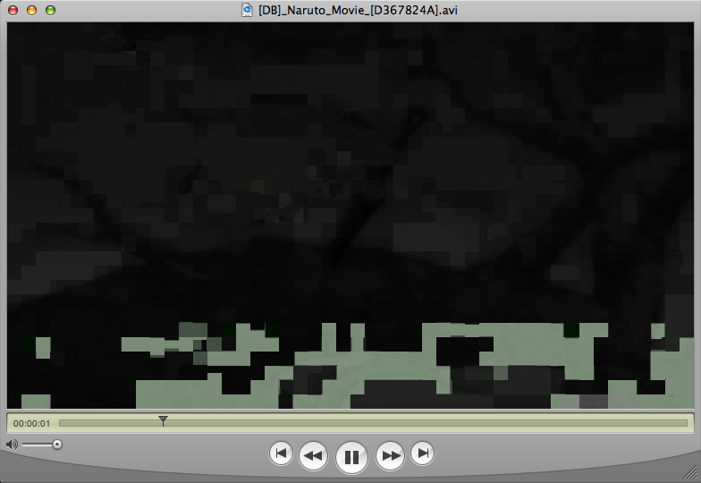

here's a screenshot of a movie encoded with xvid that i attempted to play with quicktime using 0.5.1 xvid codec. it only plays a couple of seconds of the begining, then crashes or hangs.
if i used another method, quicktime will just "unexpectedly" closed

It's just the reality of owning a Mac, I'm afraid. XviD is a codec designed and popularized on the PC, and its developers have never really paid attention to the Mac (or maintaining a current QuickTime wrapper). I'd imagine it isn't just you. If you like I could arrange to check out the file you have, see what happens for me—it might just be that file employs XviD features not supported in the codec available for the Mac. As I recall, that particular XviD build you're discussing is pretty old.

Most important thing: Your codecs appear to be working just fine. The problem you are having is that these high-compression codecs require more power than is available on your system.

QuickTime and VLC are very different animals with very different design goals. QuickTime, for which the Player is a compatible app, is the multimedia framework for MacOS X. It has to satisfy the needs of all MacOS X developers and amateur and professional media users. VLC is a player that is designed to play most multimedia files by reverse engineering their formats. As a player only, VLC is much less ambitious in its design goals than QuickTime. You cannot escape the the fact that your troublesome file is being recognized and played by your installed QuickTime codecs. You are experiencing artifacts of decoding highly compressed files. It is impossible to make a final judgment based on your single frame, but this is the kind of thing one sees in digital media when a large percentage of pixels change between consecutive frames.
