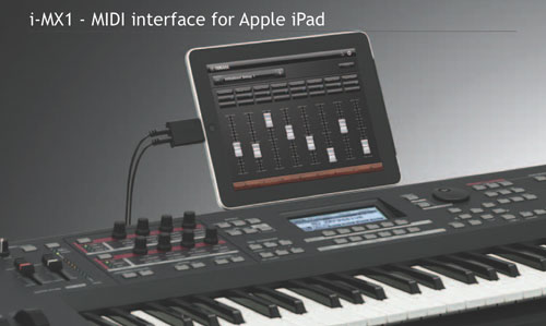

While there have been some MIDI solutions out there for the iPad and other iOS devices, Yamaha has introduced (PDF) its first MIDI interface for iOS at the Frankfurt Musicfair.
In a small, black device the i-MX1 carries the needed electronics and two connectors for the included adapter cables which represent the MIDI input and ouput (with the well known 16 MIDI channels each). It does not just connect to the iPad, but to the iPhone and the iPod Touch, too. Since these devices are much smaller, they are even more handy controllers.
The i-MX1 is compatible to the drivers provided by the iPad-OS (iOS, Core MIDI), there‘s no need for special drivers. So even third- party applications that are using the iOS drivers can use the i-MX1 as MIDI-Interface.
Hispasonic posts a photo of the box and demo video (Spanish) showing it in action. The devices works with iPad as well as iPhone and iPod. Details are rather limited at this time.

It looks like it has standard 1/8" in/out jacks. I wonder if it would take analog stereo input and output too. That would truly make it handy. But if it's only for MIDI, the device seems too specialized. There are other products on the market, like the Alesis iO dock (which obviously is a bit bulkier) that allow for MIDI and audio in and out. That seems a better investment, IMO.

It's very likely only for midi, and those can not be standard stereo 1/8" TRS... midi carries 16 channels in & out... probably can't do that with analog TRS (tip-ring-sleeve).

Standard MIDI ports are 5-pin round DIN connectors but only two pins in each connector are used for the MIDI signal. The signal is digital but would work fine with a TRS connector. All 16 channels are multiplexed over the same serial date stream. (The messages contain the channel number.)

Looks like the weight of those cables will just make the connector fall off. A separate lightweight cable to an interface a metre or so away might be a better idea to keep the weight off the connector.
