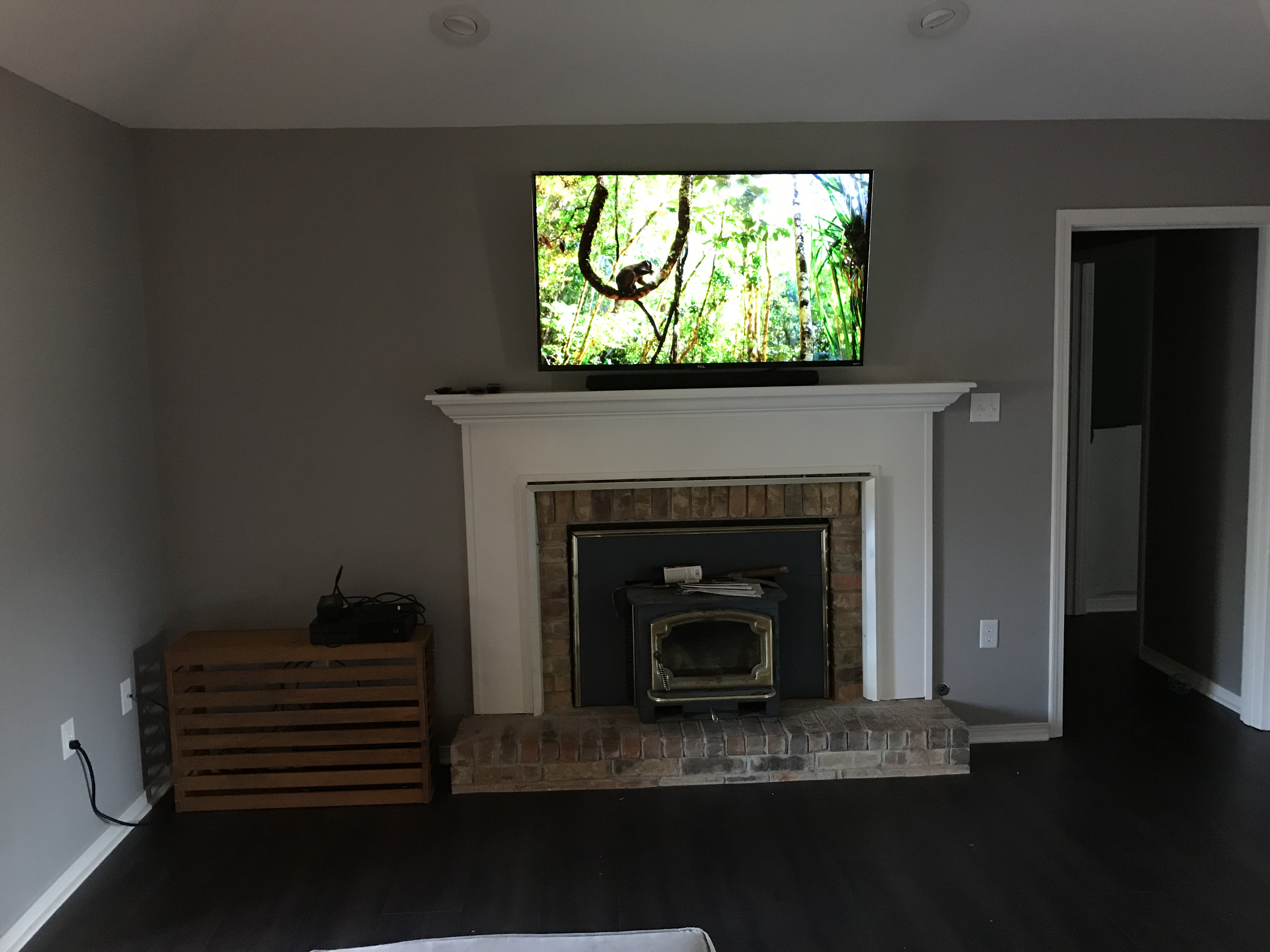

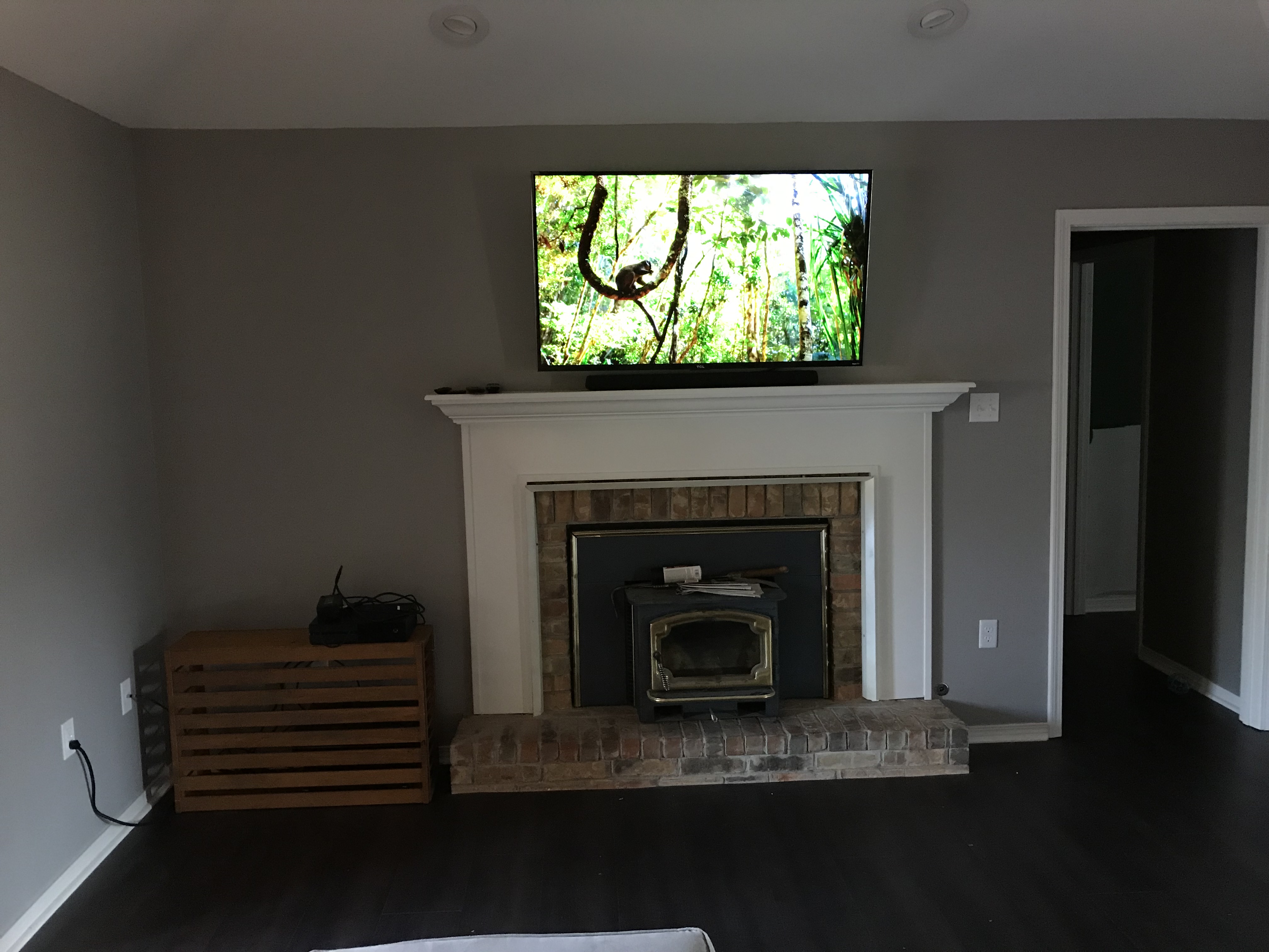

Thanks to all for your help. Now to take pics of set up, disassemble, and then get mounted on wall. Wish me luck.
Reactions: ActionableMango
Room not finished yet, but TV & sound bar up with receiver, satellite box, and Xbox to be hidden/on furniture to left.
