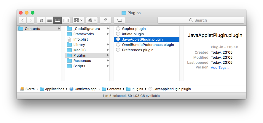

Code:
Mashemite:~ grahamperrin$ date ; sw_vers
Fri  8 Jul 2016 22:58:32 BST
ProductName:    Mac OS X
ProductVersion:    10.12
BuildVersion:    16A239j
Mashemite:~ grahamperrin$ java -version
java version "1.6.0_65"
Java(TM) SE Runtime Environment (build 1.6.0_65-b14-468-11M4833)
Java HotSpot(TM) 64-Bit Server VM (build 20.65-b04-468, mixed mode)
Mashemite:~ grahamperrin$ sudo cp -r /Library/Internet\ Plug-Ins/JavaAppletPlugin.plugin /Applications/OmniWeb.app/Contents/PlugIns
Password:
– that much works, but the Internet plug in is not recognised by Firefox or OmniWeb (and for OmniWeb, I tried plugging it into the application bundle as shown below).

Yep, above there's 1.6.0_65.
For that version to be usable you must move or remove any superior versions from /Library/Java/JavaVirtualMachines/
