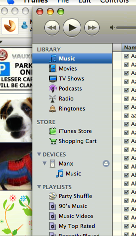

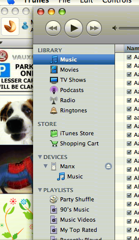

Hi.
i have an iMac G5, (ALS,1.8Ghz,17"). My Monitor is displaying jagged yellow lines all across the screen. Screen shot is attached below(look at the iTunes window). Does anyone have any idea on how to rectify this issue ?

How old is it?
Actually, is that a photo or screen grab? If it's a screen grab, it's not the monitor but actually being output like that, which would suggest graphics card.

This is a screen grab... not a photo
