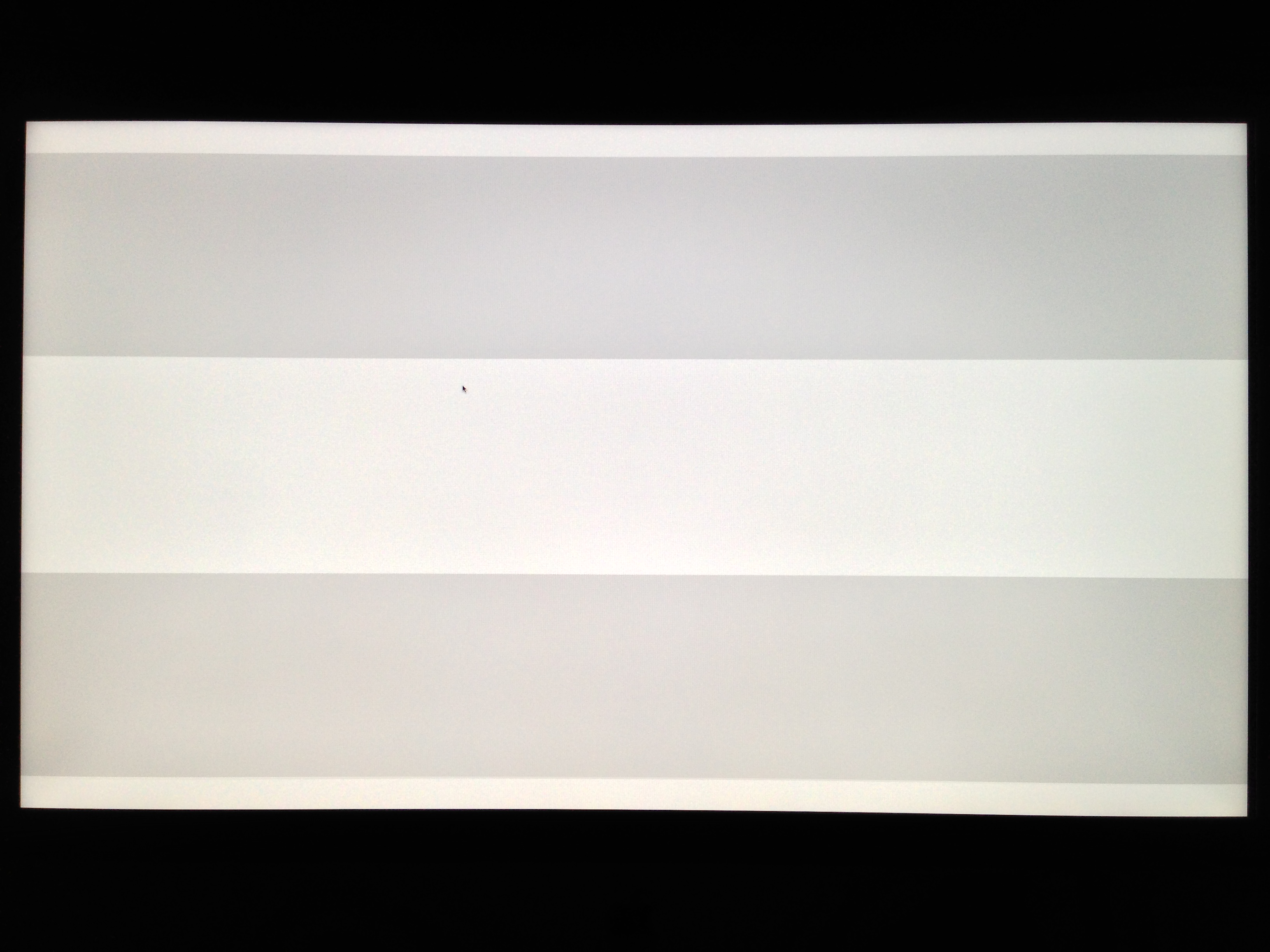

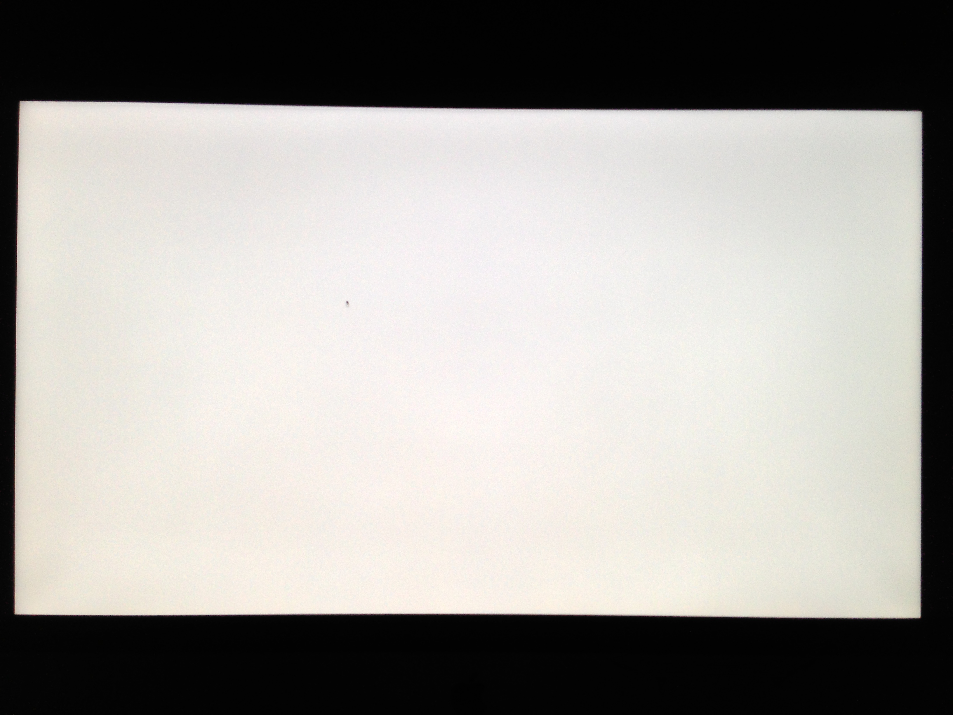

Here is my late 2012 iMac 27.
What do you think? Should I return it?

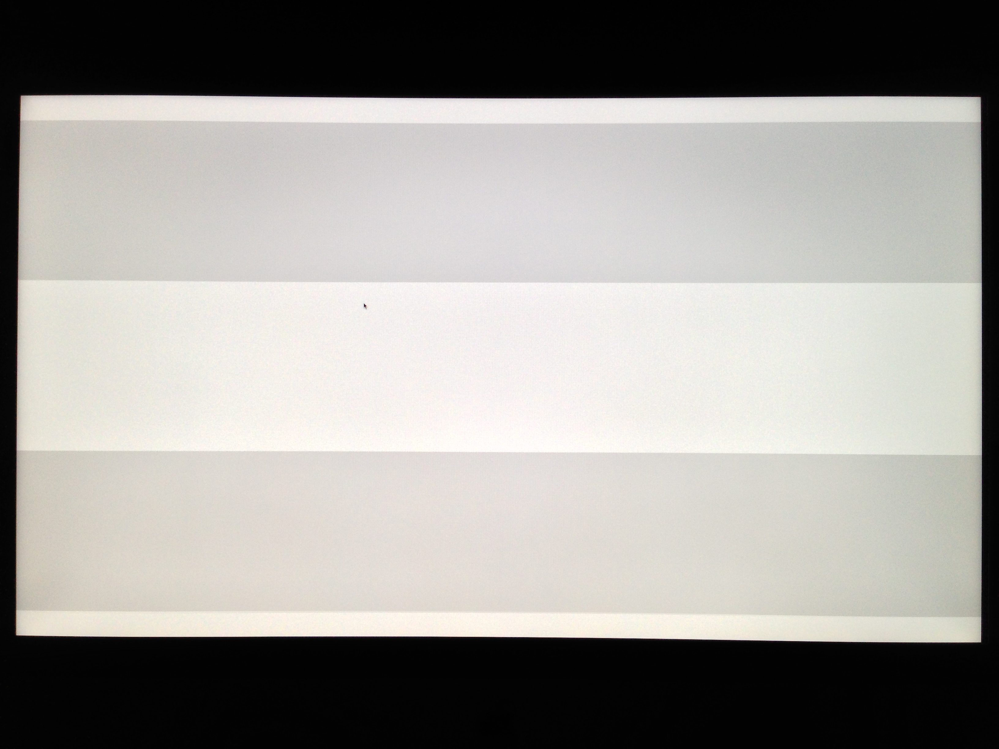

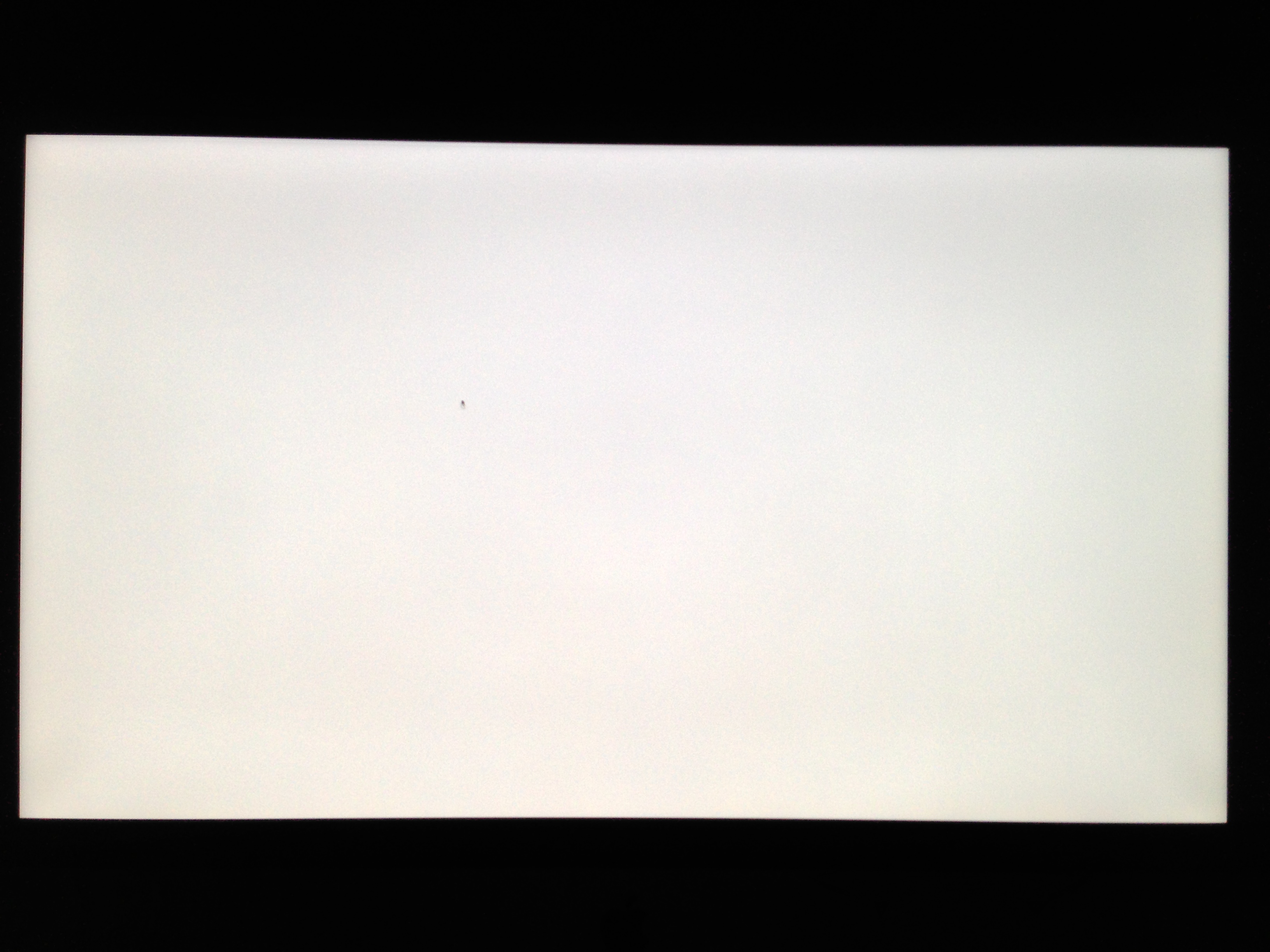

Looks to be within spec to me, especially with a calibration it will clean right up.

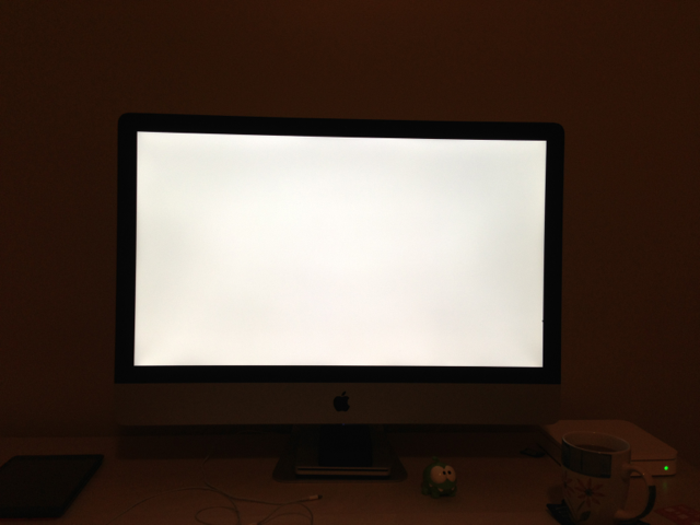

This is my iMac screen, I feel it's as close to perfect as I'm going to get.
I notice in person, a slight pinkish hue towards the lower half. I honestly think it's the anti-reflective coating since you can see a reddish hue on the glass when the iMac is off.
When viewed from ~3 ft. away it looks flawless.
