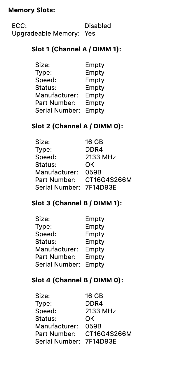

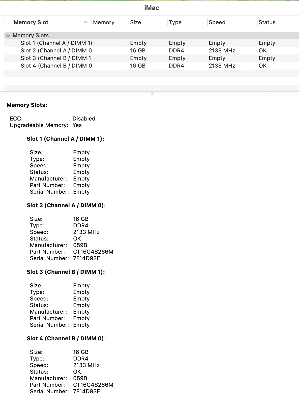

I read all the threads before installing a kit of 2x16GB Crucial RAM modules (DDR4 2666MHz, CT2K16G4S266M) into my iMac20,1 (Retina 5K, 27-inch, 2020 3.3 GHz 6-Core Intel Core i5).
I discarded Apple's stock 2x4GB modules, and installed the new ones in their place, slots 2 and 4. But I'm not getting 2667MHz.
"About this Mac" shows "32 GB 2133 MHz DDR4" and below is a screenshot from system report. The modules label do specify 2666.

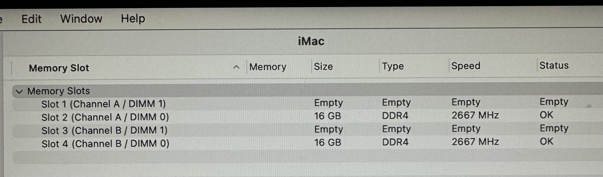

Just an FYI, I have the same computer and installed these exact RAM modules upon purchase. Mine are in slots 2 and 4 and they both show 2666.

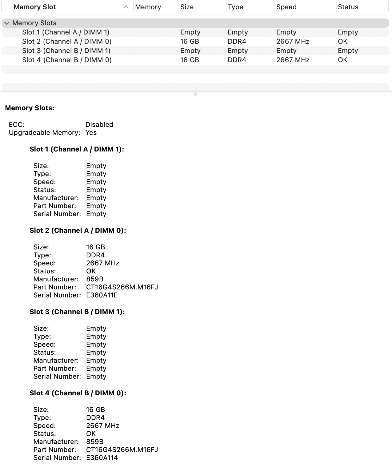

Many thanks, I appreciate it, but could you possibly shoot the memory system report?
About This Mac > More Info... > General > [scroll down to bottom] System Report... > Memory
The bottom pane has all the part and manufacturing numbers, which would show if I'm using the exact same (and correct) modules (i.e. Crucial didn't mis-label mine).
For comparison, here's my memory system report:

I bought the two Crucial modules as a kit, and their serial numbers confirm by being consecutive (per my Mac's system info, see screenshot in OP)
