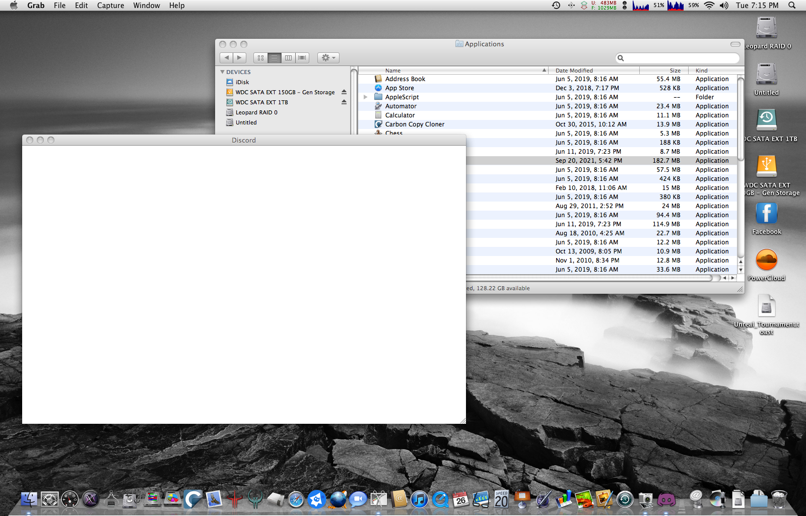

Hola mi amigos - So this is really weird. I went to cycle my DP 1ghz quicksilver this evening and now I get this. The app is still working fine on my DP 2ghz pmg5 out in the garage (used it all day) but I'm getting this white screen here.

I have deleted it and re-DL/installed via macintosh garden with the same result. Any other ideas?
Strange. Out of curiosity, does safari/webkit display properly?
Edit: also does it work with a different user account? (On the mac, not discord account).
Cheers
From what I can tell Safari 5.0.6 is displaying properly. Brought up a few websites and compared them to Safari 11.1.2 on my elcap macbook and everything looks identical. I do not have multiple user accounts on this quicksilver. I agree, this is the weirdest thing. I also tried reloading (in app rightclick, reload drop down menu) discord but that action would hang (spinning beach ball of doom) eventually crashing the mac (frozen GUI).
Again, the app is working perfectly fine on my DP2.0ghz a1047 out in my garage - Really odd.
About the only other thing i can think of you could try is....
Delete these directories:
~/Library/WebKit/Databases/___IndexedDB/com.wicknix.discord
~/Library/Preferences/com.wicknix.discord.plist
Then restart the app. Hopefully that fixes it for you as it doesn't really save any other files on the system.

Hola mi amigos - So this is really weird. I went to cycle my DP 1ghz quicksilver this evening and now I get this. The app is still working fine on my DP 2ghz pmg5 out in the garage (used it all day) but I'm getting this white screen here. View attachment 1880101
I have the same issue on fully updated 10.5.8 on an 867MHz PB G4. Discord is almost usable in Leopard-WebKit so it’s not some huge loss for me but still a bit surprising.
Well ... Last night i experienced this on one of my G5's. No idea why. Will have to look deeper in to this now that i have something to work with.
Cheers
Vidy vidy interesting. Neither filepath exists on this computer. That could be part of the problem. No worries, its still a great app, just need to figure out why it's giving us the el blanco diablo screen of death.
What I find really odd is what changed so a reinstall back to default does not fix it.
Im wondering if something changed on discords side of things. Only because last night i set up bitlbee discord on a powerbook running linux and i got a strange message about an authentication key or something. However, that still worked as it should.
Cheers
Cheers
This makes logical sense. If nothing has changed on the PowerPC side to bring on the white screen, the shift must be on Discords backend somewhere. Still, why would some machines be affected and others not be? So weird.
I'm not sure if this helps at all but I've noticed that Discord displays the same white page if you visit it (https://discord.com/login) in both TenFourFox Intel and Chrome 49 on Snow Leopard. Maybe Discord just isn't compatible with these old browsers anymore?
Sadly, my initial thought for a workaround does not work. This project had the quickest death of anything i ever made. 🙁
